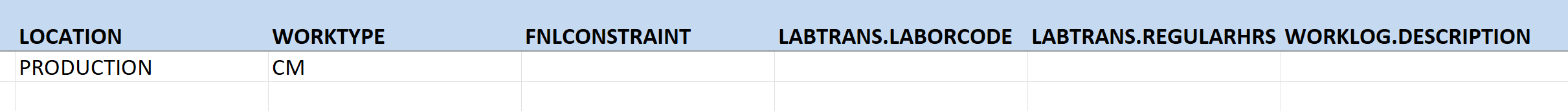

    Hello all, is it possible to add Labor and Work Log Summary to a Work Order using MXWO object with MxLoader?
    Possible use case example, if I wanted to upload a site's historical data (Pre-Maximo) if it was stored in an Excel sheet?  I think this could be especially beneficial when trying to use Predict.
    1. Are there separate objects I would have to use?
    2. Would I have to create a custom object?
    3. Can I accomplish this by a relationship?

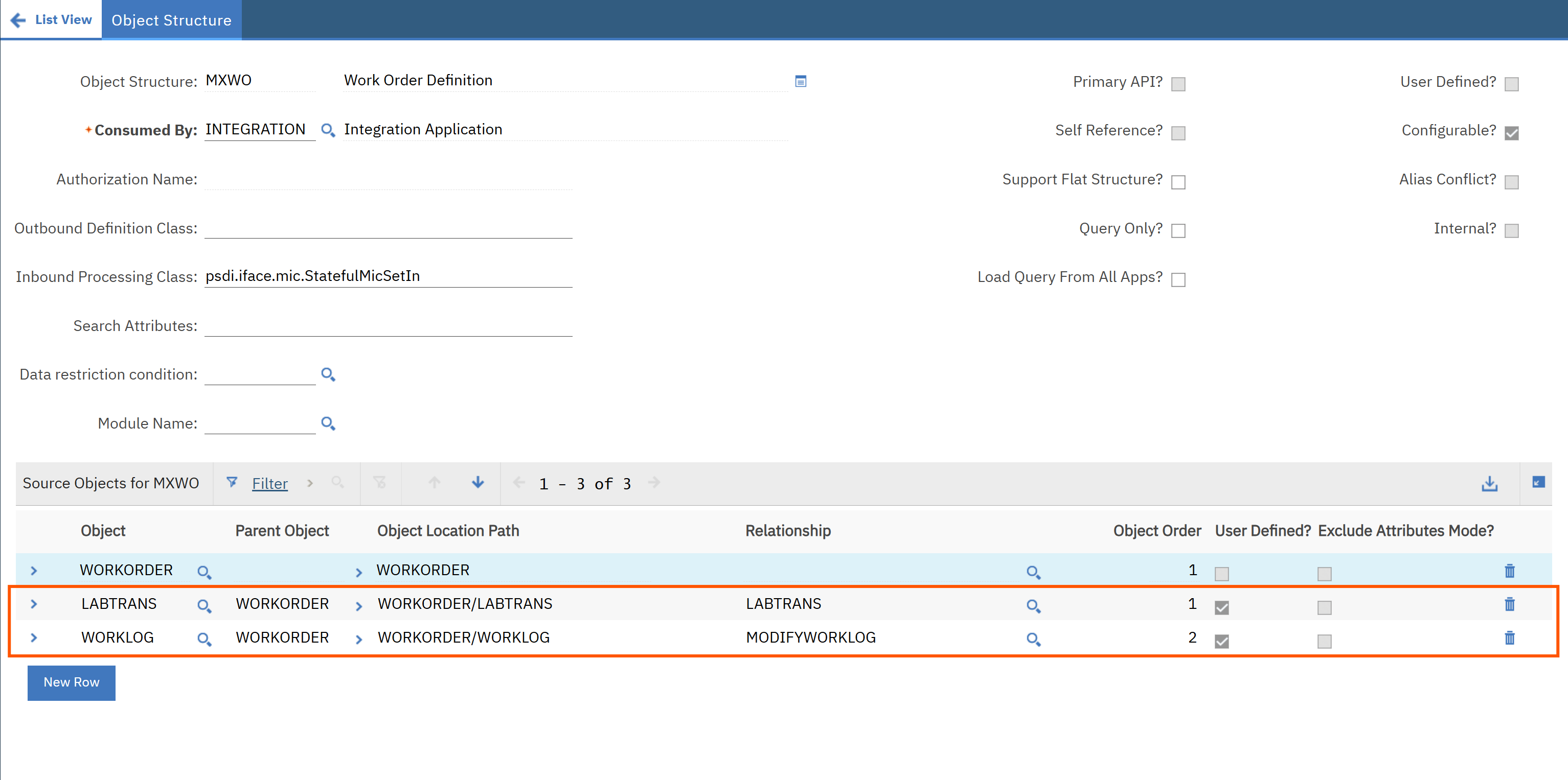

    [Update 1] I was able to achieve this by adding:

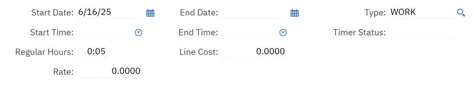

    My only issue so far is that when adding labor it is off slightly.  For example,  in MxLoader I told it to add 0:08 minutes to the work order and it added only 0:05.  (I think I have found the cause and will update once I test for anyone interested in doing this as well.)

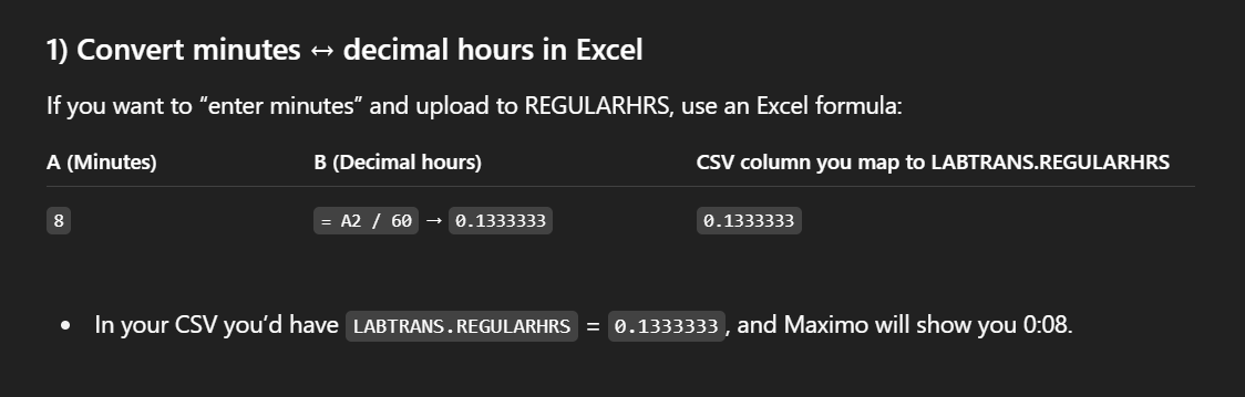

    [Update 2] I was able to get the correct 8 minutes by converting the number to decimal hours:
