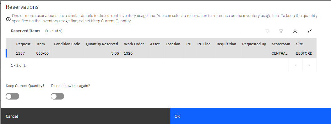

    Not quite the answer or solution.  The property mxe.app.inventor.useIssuedQtyAgainstReservations does not work or for given scenario as the user is not unapproving.
    There is only one place that Maximo recognises where the inventory issue may match a reservation, and that is using the Inventory Usage application.  The following screen shot shows the message that the user receives.
    It would be great if that existed in the other applications (and mobile) where a user could issue an item.  Sadly, I've checked, and the answer is that it does not.  Time raise an IBM Idea!  Here is the link to the idea. Please vote.
