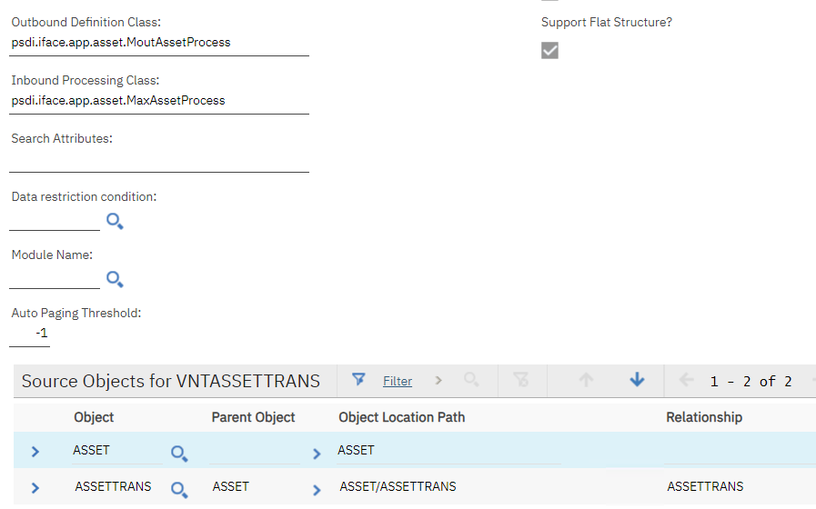

  • 5.  RE: Bulk Update Asset Location -What is the best approach?
    Posted 12-26-2023 23:25
    Hi Steven,
    Thanks for the detailed clarification.
    As you mentioend, the Data import validates, location status etc.
    I tested using Object structure of ASSET, ASSETTRANS tables and default Asset Processing inbound class.
    Kindly let me know if we need to include any other objects.
    Thanks!
    Sankar Ganesh V S
    DXC Technology
