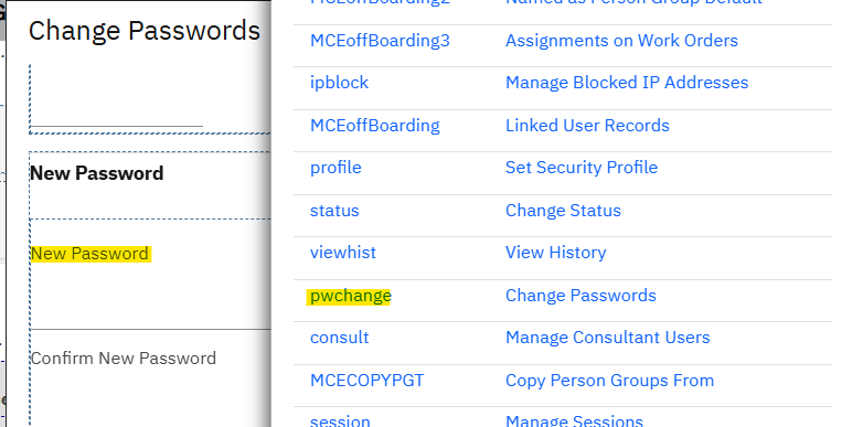

    I have been asked if it is possible to update the New Password Message.  I did not see it in Messages under Database Configuration so I was curious where this message is located and if it is possible to edit.  Thank you.

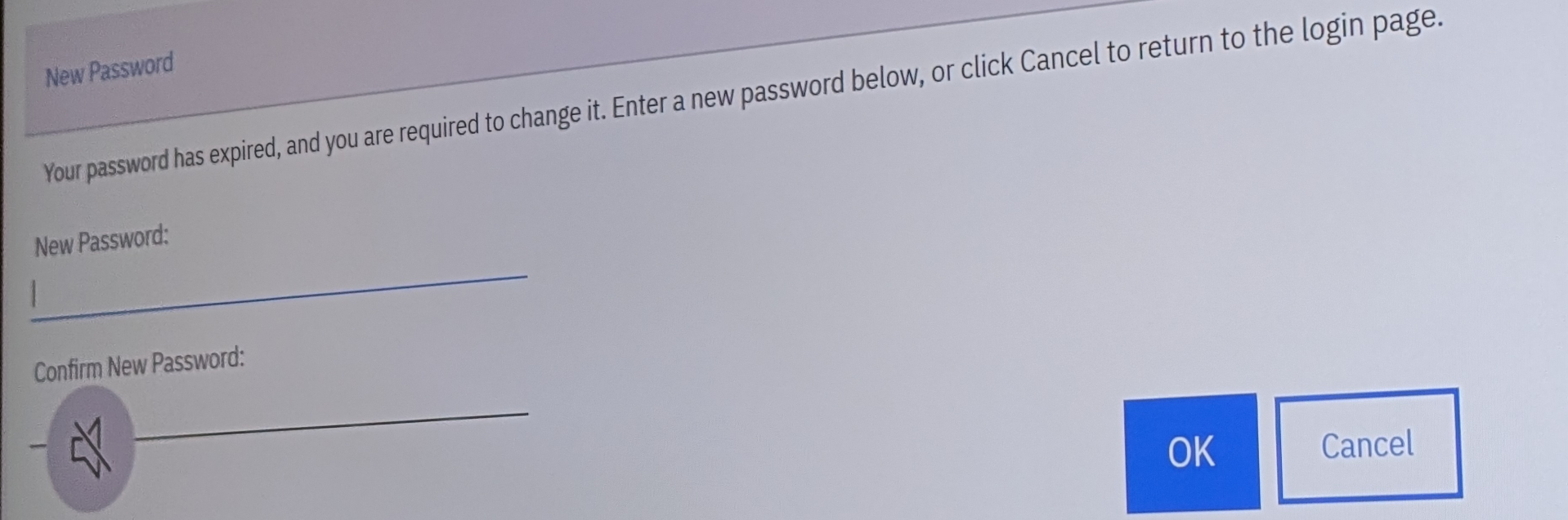

    I think you're talking about the "Your password has expired, and you are required to change it. Enter a new password below, or click Cancel to return to the login page." or the new Password/Confirm New Password.
    The "your password has expired" message is set in the CHANGEPSWD application in Application Designer as a description for the section. You'd want to update this here.
    The New Password/Confirm New Password labels you could override in the application, but I'd recommend adjusting the titles in Database Configuration instead. If you open the CHANGEPASSWORDS object in Database Configuration, you can update the title for PASSWORDINPUT & PASSWORDCHECK.
    The reason I suggest using Database Configuration instead is it uses the title currently. Once you create a label override, it's specific to this application and will need to be translated for each language if you have multiple languages installed. Otherwise, every user would see the English description.
    I see a lot of customers override labels in Application Designer and then they access the same attributes in other applications or dialogs and have label mismatches. That's why whenever possible I try to keep the changes contained in Database Configuration to propagate everywhere.
  • 4.  RE: Change Password Message
    Posted 10-11-2025 11:09
    Thank you @Sankar Ganesh V S and @Steven Shull.  This screen is what is shown when I send a temporary password and they must change it the first time they log in.  So I'm not sure if it is something different.
