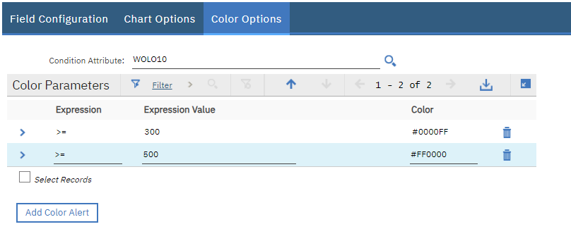

  • 2.  RE: Color-Coding - Start Center Result Sets - Multiple Colors
    Posted 04-30-2024 11:03
    Edited by Prajesh Pradhananga 04-30-2024 11:04
    If you start with lower boundary which is 300 in your color parameter, I think it should work. May be try below:
    PJ
