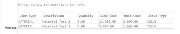

    Hi Sammy-Joe,
    I did a quick test with a Python script to build out a table of Actual Materials (you'll need to add more if you wanted to include Planned as well). Aside from the script, I created a Relationship on the COMMLOG object to WORKORDER and leveraging the existing Relationship to MATUSETRANS on the WORKORDER object. The read-only conditions may not be required in your case, if so, you can strip it out.
    See below:

    Hope this helps. Let us know how you make out.
    Cheers,
    Matt F
