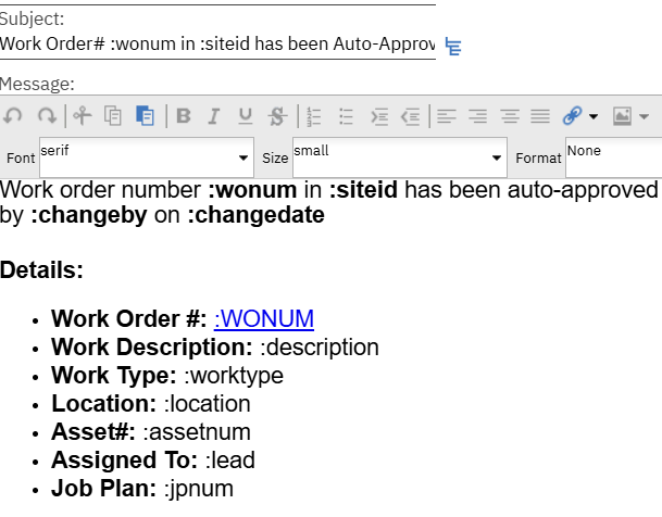

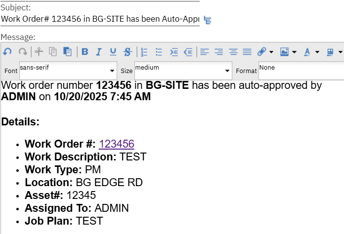

    Hello All,
    I have encountered an issue where a deployed workflow is altering a communication template used in the workflow, anyone else encountred a similar issue?  Some of the items tested to debug the issue:
    1. Disabling all automation scripts
    2. Disabling other work flows
    3. Disabling escalations
  • 2.  RE: Communication Template getting overwritten

    We had same issue in manage 9.0.14.  IBM has provided a fix for this.

    please have a look at:
    Known Issue: DT443650
    We have similar issue, but related to re-assignment WF record.
    HTH & have a great day ahead
    Chavdar
    P.S. It is included in Maximo 7.6.1.3  iFix 36
