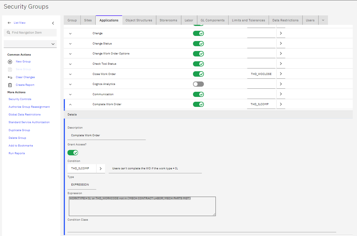

    I have applied a Conditional Expression on a Security Group for the "Complete Work Order" option in the Work Order Tracking application. The purpose of this condition is to restrict users in this Security Group from completing a work order unless one of the following requirements is met:
    1. The work type is not equal to 'IL'.
    2. The work code is not equal to 'MECH CONTRACT LABOR' or 'MECH PARTS MGT'.
    The condition I have written is as follows: WORKTYPE!='IL' or THD_WORKCODE not in ('MECH CONTRACT LABOR','MECH PARTS MGT').
    However, during testing, I have observed that a user in this security group is unable to complete a work order when both requirements are met. I am seeking assistance to understand why the condition is not functioning as expected. I would appreciate any insights or guidance you can provide to help resolve this issue.

    Thanks Dragos. I have tested your expression, but I am still able to Complete the WO unless both requirements are met. I don't know why the "OR" is not being triggered. The system is processing the OR as an AND, and it shouldn't. Has anyone else experienced this with conditional expressions?

    Same thing happens. I am able to Complete the WO unless both requirements are met. Your expression makes total sense, so I don't understand why it isn't being applied correctly.

    Thank you both for your help, but I am still having the same issue. I have tried all the conditions you both have recommended, but I am still able to complete the WO unless both the Work Type = IL AND the Work Code = 'MECH CONTRACT LABOR' or 'MECH PARTS MGT'. I am not sure why it's not working.

    Thank you, James. I have replaced 'SECURITYGROUPNAME' with the actual security group, and I have applied this condition to the COMP value of the WOSTATUS domain and set the object to WORKORDER. Now, I am able to complete a WO even if work type = IL and Work Code = 'MECH CONTRACT LABOR' or 'MECH PARTS MGT'
