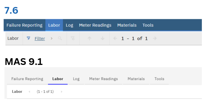

    Is it possible to use the CSS function, or something similar, in MAS 9.1 to have a blue background look similar to 7.6 on tab groups?

    Hi Danny,
    I don't know the exact CSS to change as I have not done this specifically, but I would think it is possible. This IBM Link may help get you where you need to go: https://www.ibm.com/docs/en/masv-and-l/cd?topic=interface-updating-user
    As a tip- I have used DevTools to find the CSS that needs to be changed.

    Danny,
    Try something like this as a start:
    .tabgroup A {
       color: #ffffff;
        background-color: <devtools-color-swatch tabindex="-1"></devtools-color-swatch>#325C80 !important;
