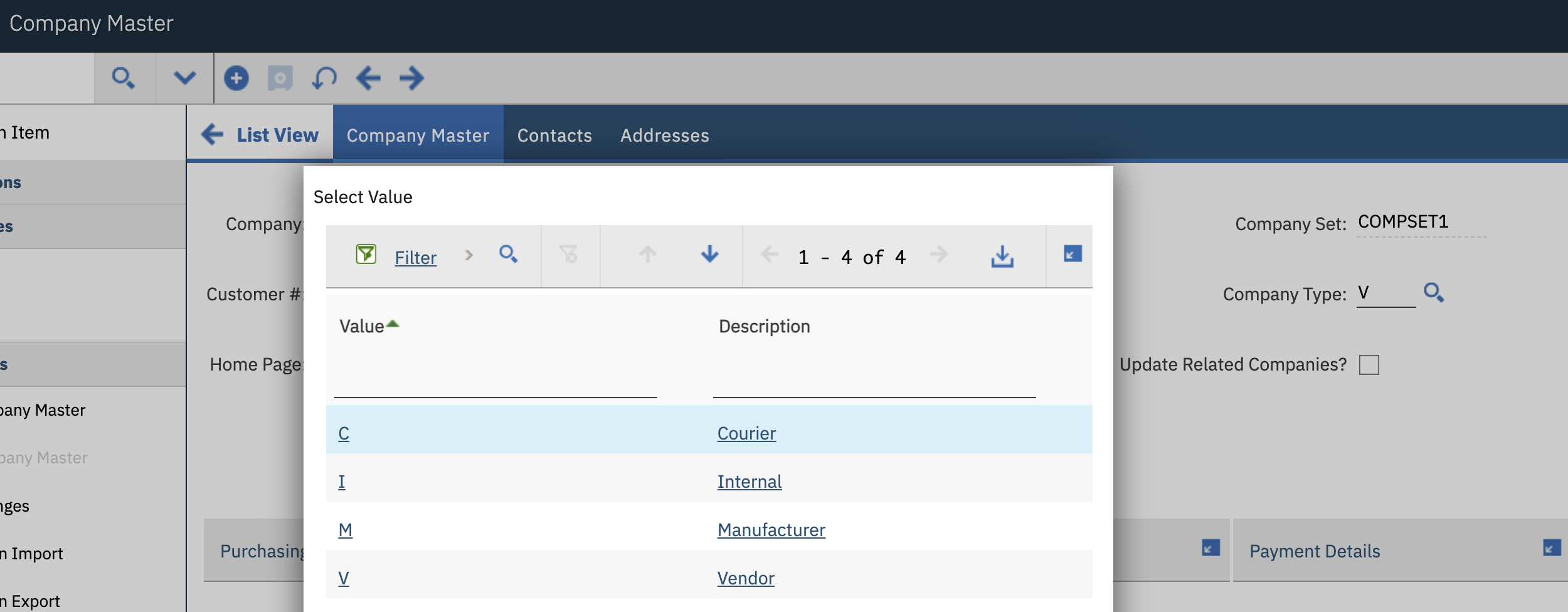

    Hello all, we do not have Service Provider, and probably won't be getting it, but I am looking for a better way to track our customers in Maximo.  One way is to create a custom Company Type of "Customer" for the Company Master application in the COMPTYPE domain.
    Is there any reason an expert might say this is a bad solution?
    My thought is that then I can use a custom field in the Asset's application to add records from the Companies application as the customer, either if they are the owner of the asset or if they are the only customer of the product produced by that asset.
