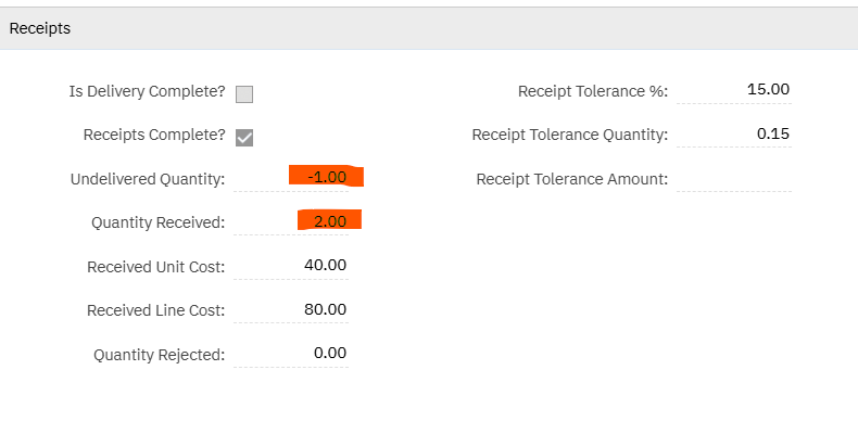

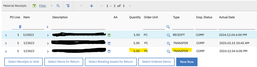

    Ref image for issue 1 from Receiving Application.
    The PO line Quantity is 1 in Purchase Order Application.
    The Quantity Received here should be 1 but due to this double posting it got increased the value.
    We have observed similar occurrences across multiple POs, regardless of whether they contain single or multiple PO lines.

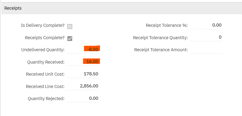

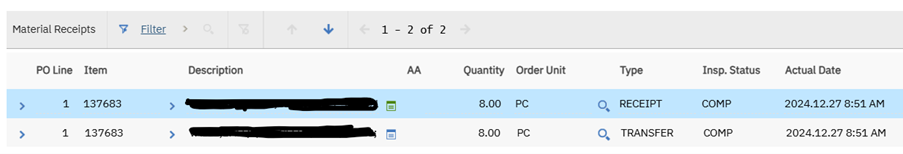

    Ref image for issue 2 from Receiving Application.
    There is no double posting line in Receiving Application.
    The PO line Quantity is 8 in Purchase Order Application.
    The Quantity Received here should be 8 but due to this double posting it got increased the value.
