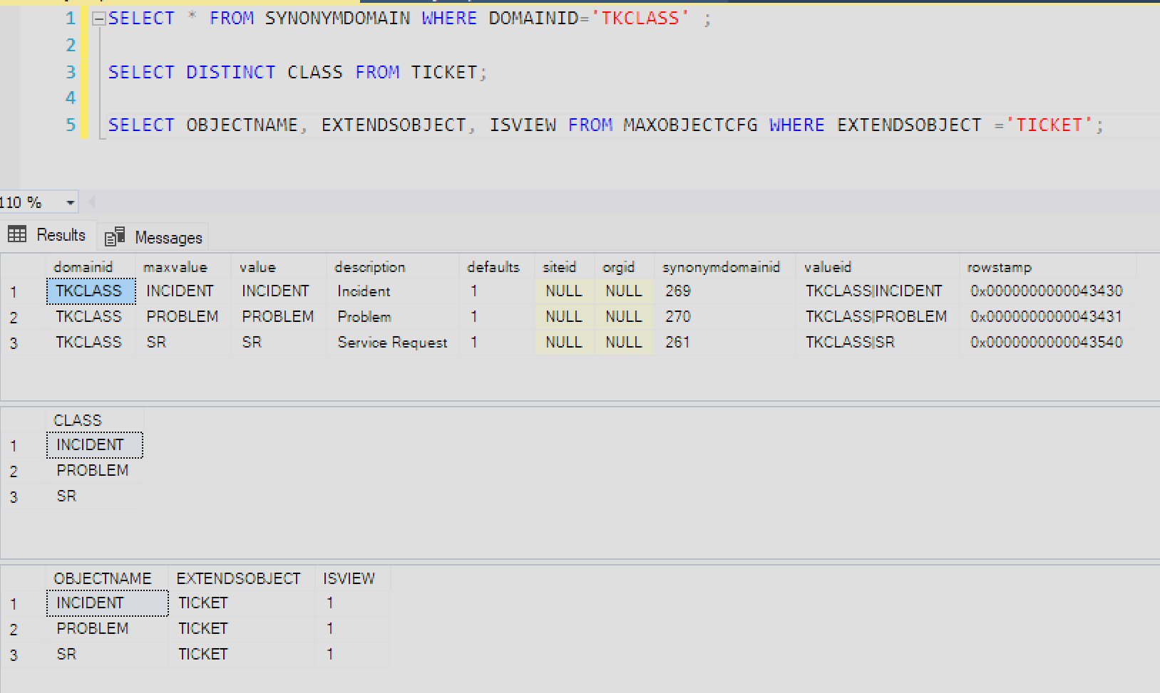

    To answer your question accurately, additional context might be needed. Assuming that you have two unique objects with an SR reference, SR and MXSR, and you're noticing duplicate SRNUMs. Duplicate SRNUMs for the two unique objects indicate that unique Ticket Classes exist.
    For example, the SR object is a view. An extension of the TICKET object of class 'SR'. The SQL screenshot provides a correlation context of Maximo's OOB TICKET object extensions SR, INCIDENT, and PROBLEM.

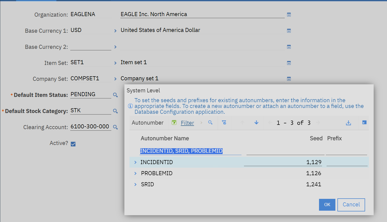

    Solution Option 1:
    • Adding a prefix is an OOB option to differentiate ticket-related Objects.
    • All objects that extend TICKET are SYSTEM-level objects with identical seeds.
    • To mitigate duplicate SR numbers, adding a prefix would mitigate duplicates from ever occurring.
    • For example:
      • SR1000
      • INC1000
      • PROB1000
      • Or in your scenario, MXSR1000
