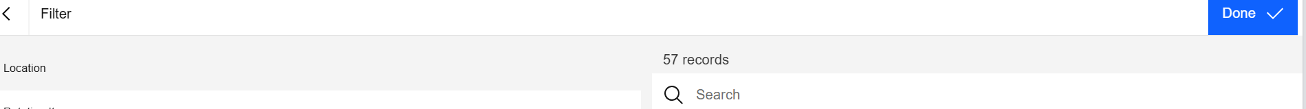

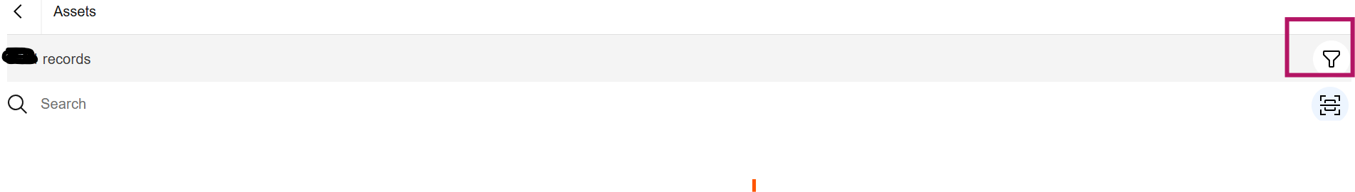

    Hi Team,
    In additional filter option, can we implemented dynamic filteration basis on different field's value ?
    I have implemented additional filter option and that is working. but I want this additonal filter option should display data basis on other field value. Main Lookup is working and displaying data basis on different field's value.
    Please help.

    I appolize not to put clear requirement.
    My query regarding Maximo mobile configuration only , not for maximo.
    In additional filter , not able to filters data basis on other filed's value.
