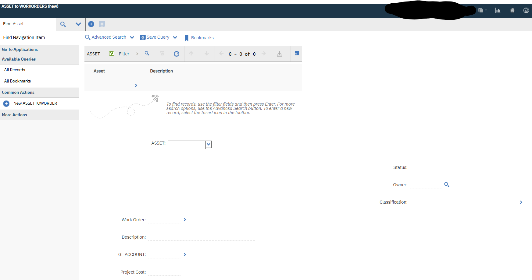

    I have created an custom application called Asset to Workorders and the main objective is that a user can see work orders to assets including the GL accounts(project, cost categories) etc.  What I want to be able to do is that when I click on new ASSET, it should automatically populate the other fields such as work order, description, GL Account, Project code.  Here is what it looks like:

    Create an asset
    I'm going to assume that this application will be a Single Page App.  I see in the supplied picture that it fits that style rather than a Power App.  Is that correct?  It is unusual, but okay, go for it.  You will need the summary row also to have an expanded section.  I cannot see that in your current design. I'll assume that you've based this application on the asset object and therefore the asset number will be automatically set, provided the field is defined in that manner.
    Defaulted fields
    For all defaulted fields, where do you expect to get the data?  Is it set at the database level, through the UI, or via an automation script?
    I these fields are to come from a work order, then which work order because an asset can be linked to multiple work orders.  Let me assume that you select the work order.  This means that the GL account, project code, project cost, and description are in fact from that work order and can be displayed using a relationship.
    Additional fields not yet mentioned
    Status
    I'm going to assume that you intended that this is the status field of the asset and therefore...wait a minute, you have it shown as read-only, please confirm as my answer will differ.  If asset, then why read-only unless you never intend to change it from this application, or if work order, then just display it using a relationship.
    Classification
    Very similar question to the status.
    Owner

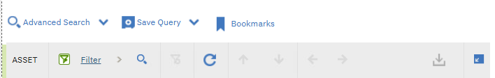

    • Actually, when I started designing the app in application designer, I did use Power app.  When you say Summary Row, is that this field:

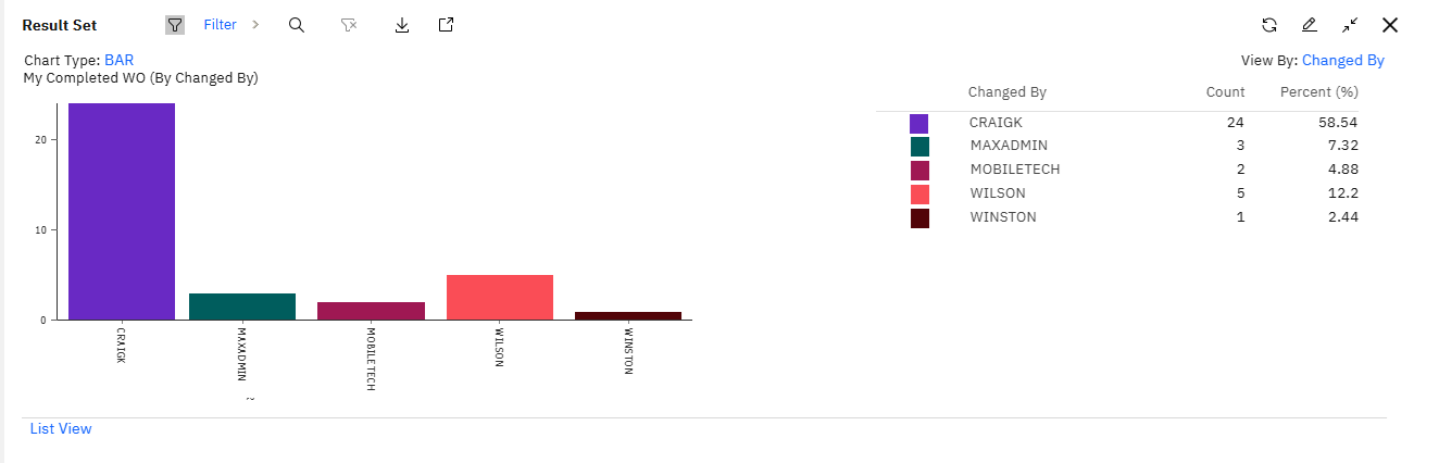

    Hi GB
    In regards to the start center, you could look at using a result set like I have below.  The underlying query could restrict the date range, but please note that it only shows count by employee, not by month.
    You may be after a report as you mentioned that "users must be able to select an employee" in other words, the EMPLOYEE must be a parameter, and "show the work order completion by month", you need a dimension of a date (WORKORDER.ACTUALFINISH???).  How far out do the timeline stretch out?

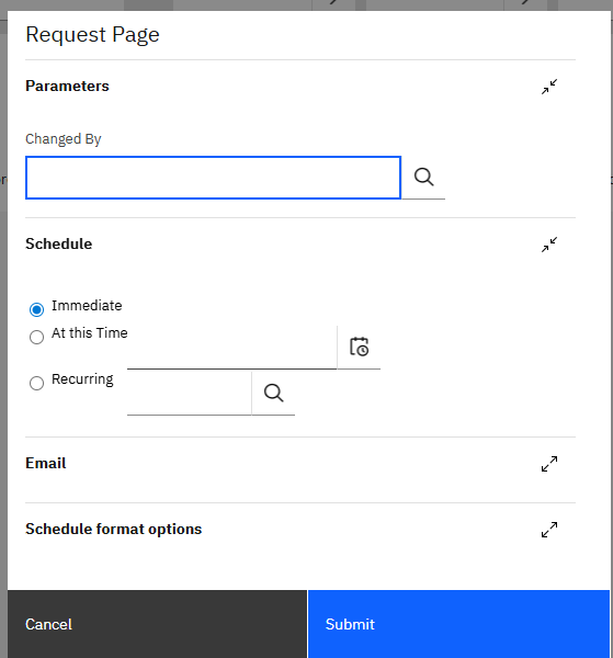

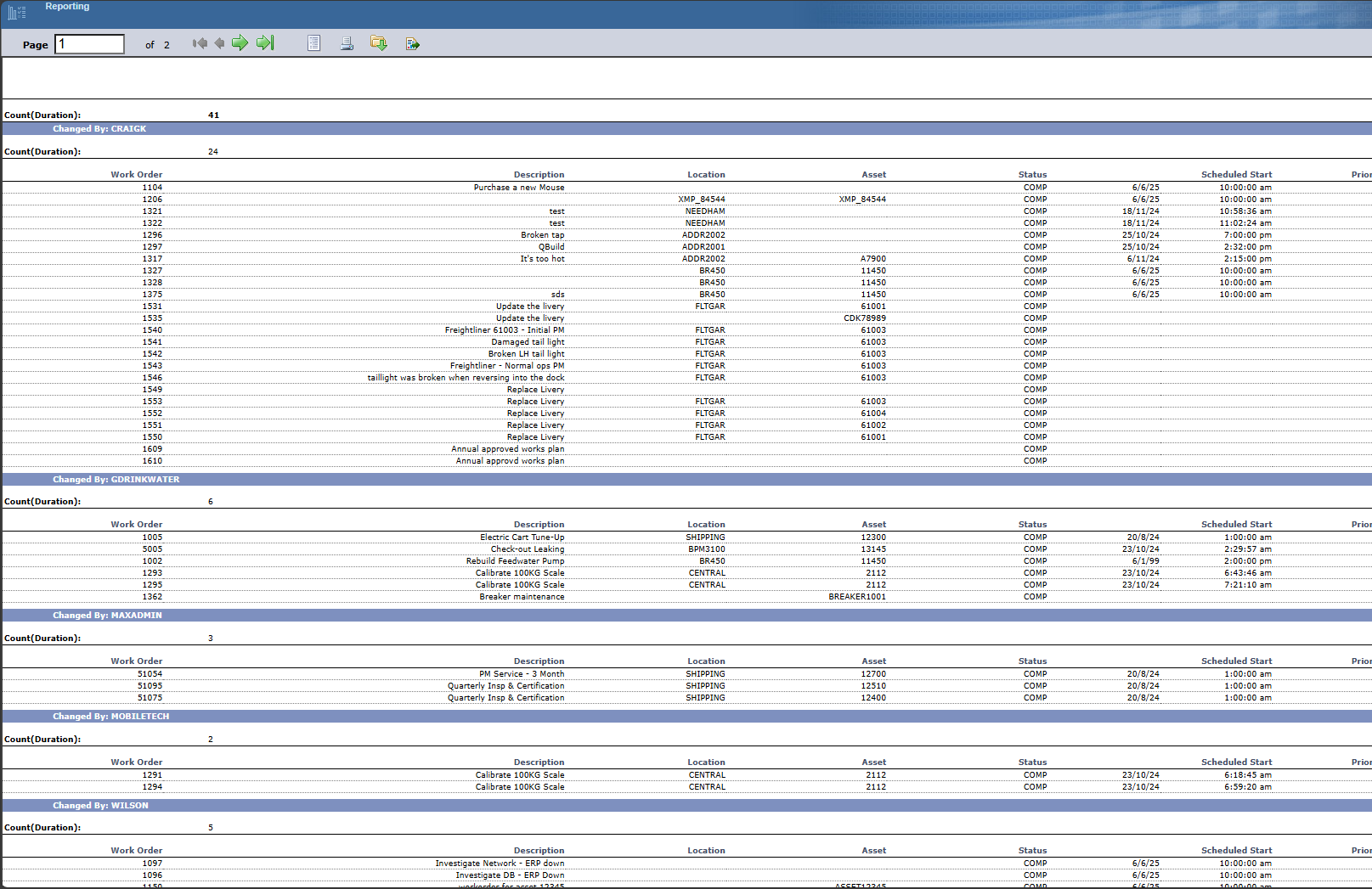

    The following is an ad-hoc report that I created based on the above data via the saved query.
    It has the capability to all the user to filter by employee
    But the QBR, does not do graphs.  For that you would have to export the design, import to BIRT, add the graphs, and re-import to Maximo.
