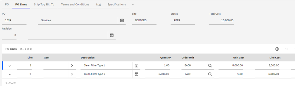

    I had the same case for an implementation, but a workaround was placed by interchanging quantity with unit cost. This is only a workaround as the 3-way matching in Maximo is on the quantity and not the cost. Not sure if this will help as a solution to your business.
    Interchange quantity with unit cost. Line 1 is what you do now. Line 2 is a workaround by interchanging quantity with unit cost. Line cost is the same.

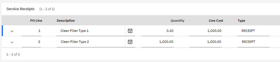

    Receive partially:
    Line 1: calculate quantity to receive which recalculates received line cost
    Line 2: receive the cost you need to receive which recalculates the received line cost
    Receipts for Line 1: Quantity received to receive the partial cost
    Receipts for Line 2: Cost received on quantity field to receive partial cost

    1. Swap the quantity and line cost.
      1. Quantity = 5,000
      2. Unit cost = $1.00
    2. Receive the quantity as a portion of the cost
      1. Quantity = 1
      2. Unit cost = $5,000
    For option 1, when you receive the invoice, you simply take the invoice total as the receiving qty.
    For option 2, when you receive the invoice, you have to calculate the % being received at the qty i.e. I have an invoice for $2,278 or 0.4556.  An issue with this approach is that Maximo is currently set to two-decimal places, but to be accurate, I need four otherwise rounding will occur.
