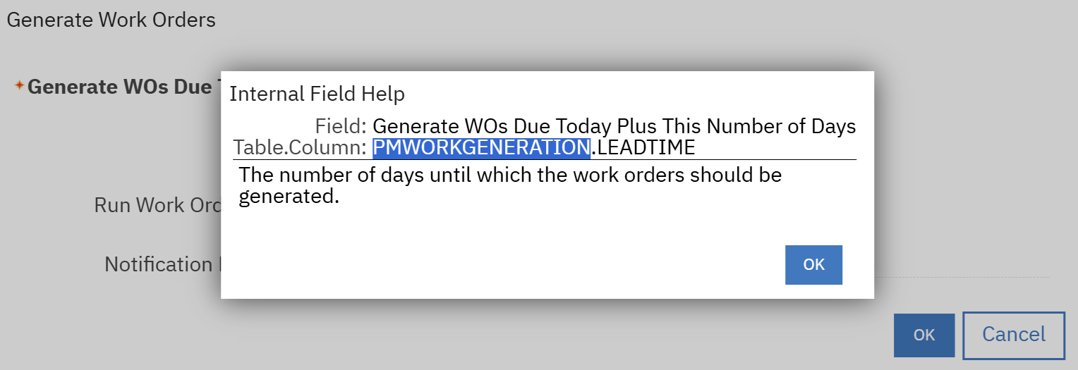

    Hello MORE Maximo community,
    I would like to check who has been manually generating PMs because I am wanting to make a change to a Security Group.
    I see that the name is PMWORKGENERATION but there is not a table or view that I see available in the database with that name.
    Does anyone have any suggestions on how to see the information I need?
