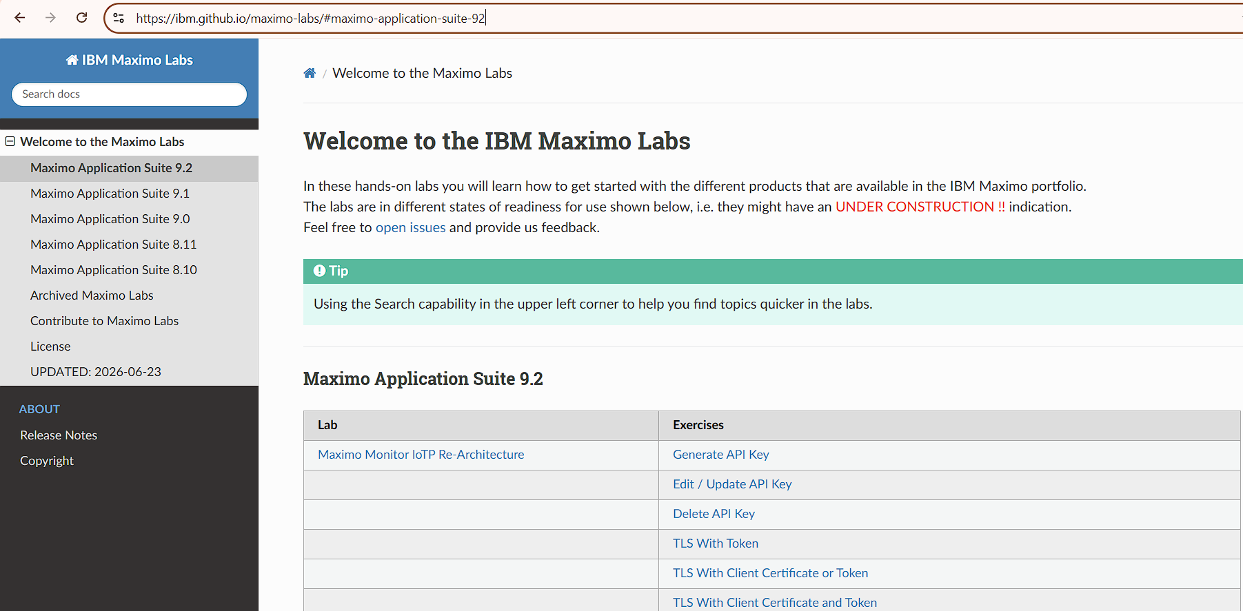

    Are you familiar with
    IBM Maximo Labs?
    1.    IBM Maximo Labs cover a broad spectrum of topics and are structured to build the foundation required to understand your unique business case and define the requirements to implement the right solution from the IBM Maximo portfolio.
    2.    IBM Maximo Labs are version-specific.
    3.    IBM Maximo Labs provide practical guides and checklists that ensure you enforce E2E best practices throughout your implementation's SDLC lifecycle.

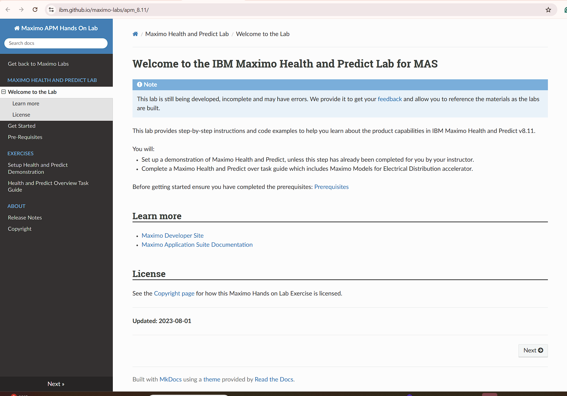

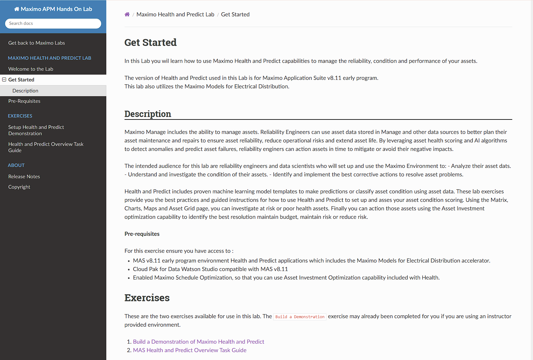

    As a practical, step-by-step blueprint, use the public IBM Maximo Hands-On Labs Catalog. Specifically, the Maximo Health & Predict lab modules provide comprehensive exercises on:
    • Condition Monitoring Configuration: Mapping meter data directly to assets.
    • Threshold & Limit Logic: Defining upper/lower limits (like your 72–90 gauge thresholds) in the system backend.
    • Automated Work Queues: Triggering automatic follow-up actions, notifications, or corrective work orders the moment a recorded inspection value falls outside the normal operating zone.
    By managing the limits via Maximo's core condition monitoring engine rather than hardcoding them into a mobile form UI, you maintain data integrity while ensuring critical assets automatically get the immediate engineering attention they need. The documentation and guides are completely open-source and can be reviewed at ibm.github.io/maximo-labs/. I have attached PDF examples of the Build and Test Guides for MAS v8.11.
