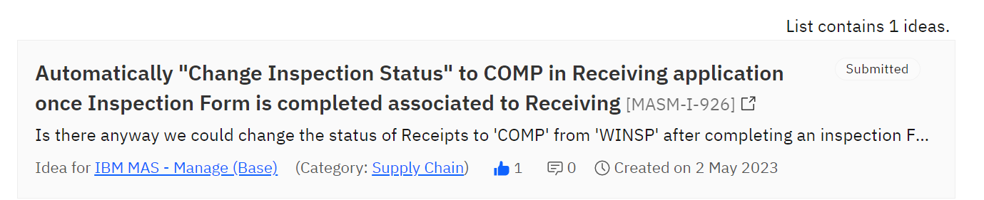

Hi Sean,
Good Morning,
Thank You for the inputs you have provided, have one question, so when the workorder is completed (COMP) status, are y'all triggering it to status of WINSP via Automation Script, (assuming) ,if the Materials in the "Actuals" tab have been received via reordering .Also, will the status be changed to "Inspection completed", at the point of when the Materials in the "Actuals" tab have been inspected by completing the inspection . Trying to understand "what bin the material passed Inspection? "
Kalpana K

Hey KK!! Could potentially do this through an Automation Script. We're doing something similar with another client. We use a clone of WO to track the inspection activities, when the Inspection WO gets set to COMP, we trigger the Change Inspection Status via Automation Script to update the inspection status and bin the material that has passed inspection.
