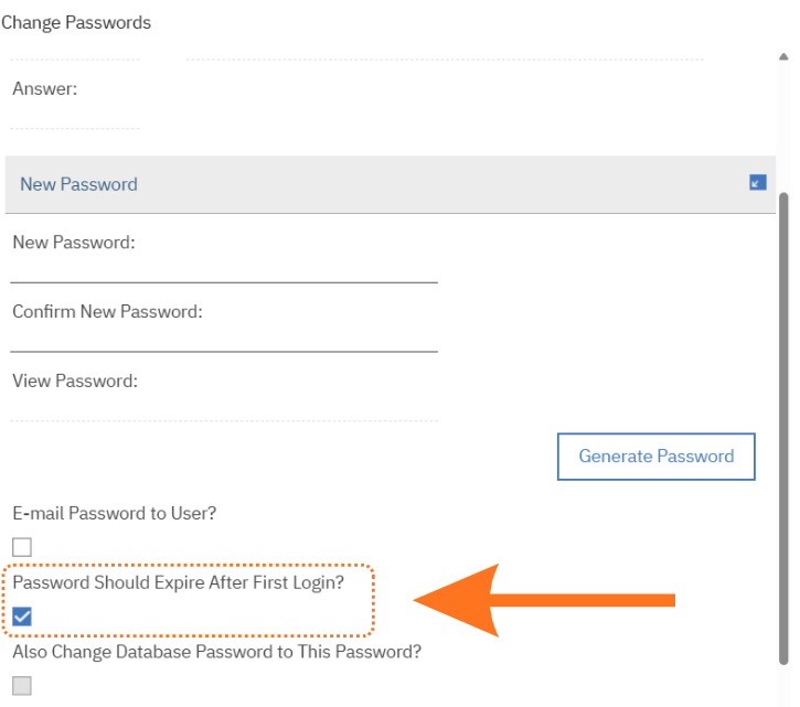

Is the "Password Should Expire After First Login?" option available in MAS 9.1?
  • 1.  Is the "Password Should Expire After First Login?" option available in MAS 9.1?
    Posted 03-11-2026 17:23

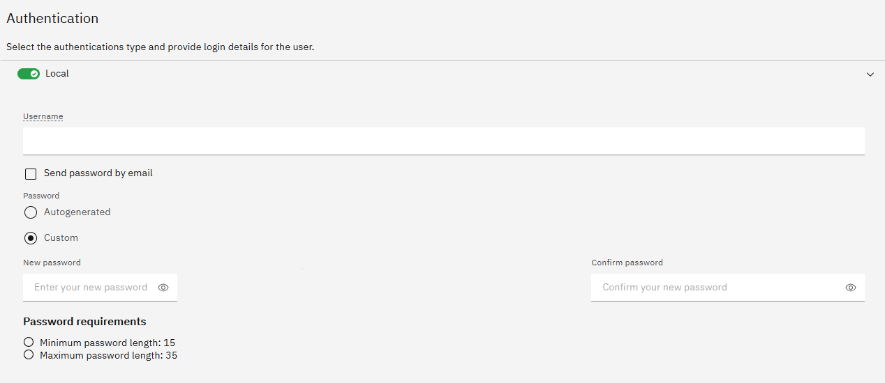

    Is the "Password Should Expire After First Login?" option available in MAS 9.1?  When we roll out MAS I'm wondering if I can give a generic password to all users and have it expire after first log in.
    I only see these options for MAS passwords:

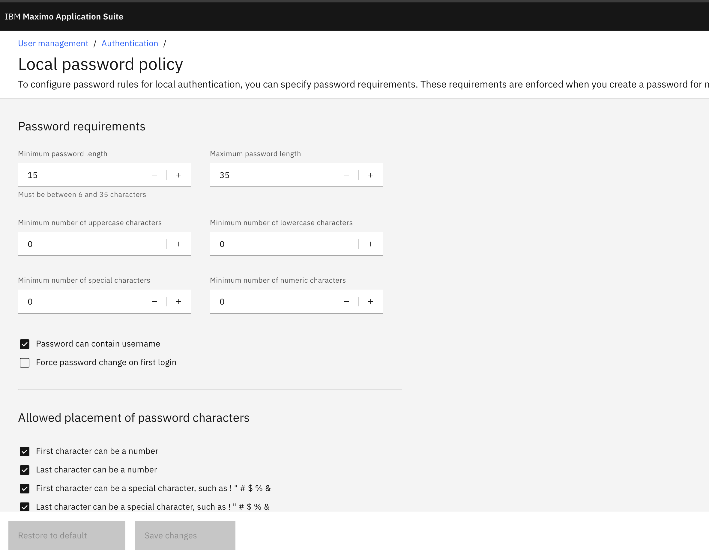

    Hi Danny,
    I believe this is available, but not on a per user basis. I believe this is a MAS Core setting now and is implemented for all users. To set it login to the MAS Core > Authentication > Under Identity Providers hover over Local > On the right side should be 3 dots > Configure Password Rules. Here you will see the screen I have attached below. Within here is a check box for "Force Password change on First Login". My experience with this, albiet limited, is that anytime the password is changed through MAS Core - it requires the user to reset their login aft logging in the first time.
