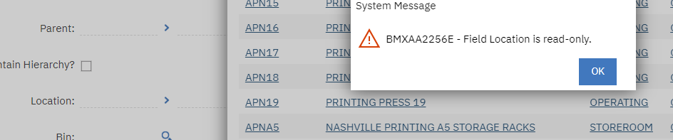

    Getting this error message when selection a location when creating a new asset. Any idea?

    If you already saved the asset, then the location will become read only and you will need to use the Move/Modify action to fix it. The location field is only read-write during asset creation before the first save.

    Thanks, that did it!
