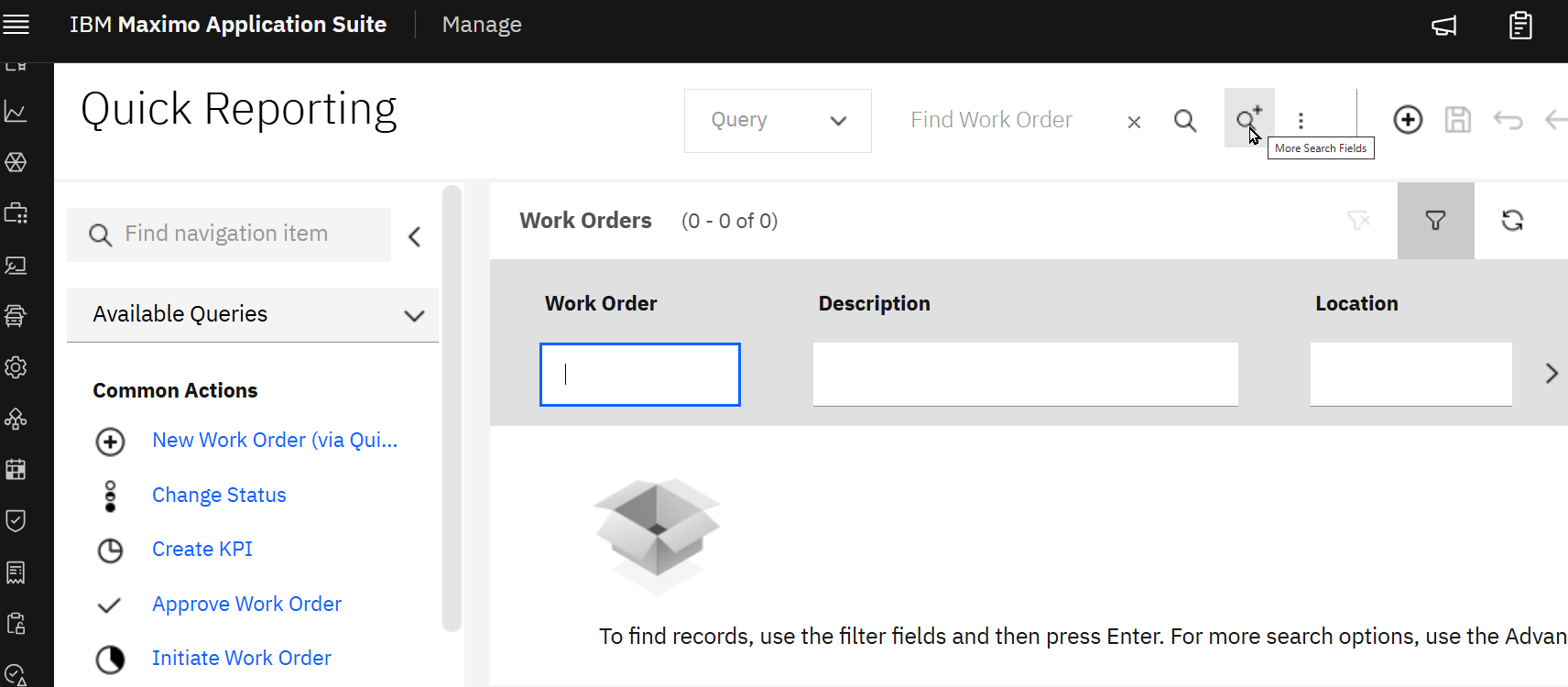

    When the list view is blank - there is text displayed
    To find records, use the filter fields and then press Enter. For more search options, use the Advanced Search button. To enter a new record, select the Insert icon in the toolbar.
    Given that MAS no longer has an "Advanced Search button" and a only More Search option
    Does anyone know where this text is located so we might change it?

    This is the Maximo message
    group: tableinfo
    key: listTableStartEmptyMsg
    You can modify this in Database Configuration to change the text.

    Just so you know, the 'More Search Fields' button is back on the list tab in the applications for 9.1. It just moved a little and some might say it is hidden in plain sight.
