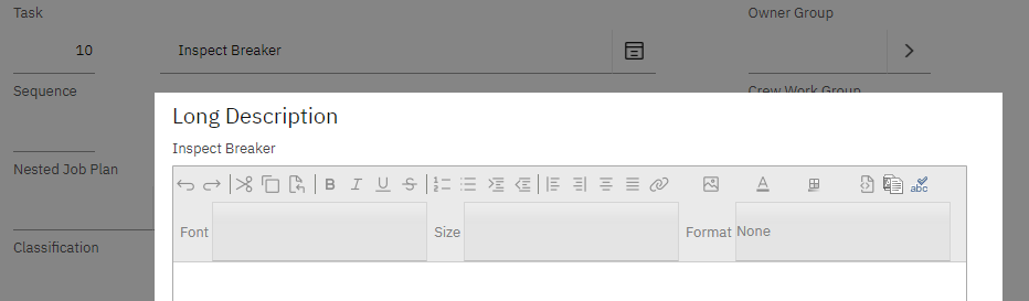

    it should not have been removed due to the upgrade.  Please check if there is still JOBTASK.HASLD and JOBTASK.DESCRTION_LONGDESCRIPTION.  If yes, then most likely its a screen thing

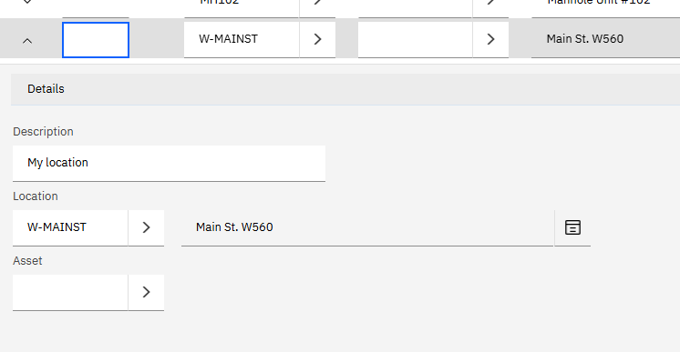

    My bad! I mixed up ROUTESTOPS and JOBTASK!
    Question is regarding Routestops. Jobtasks is OK longdescription is there but on routestops I don't have HASLD in routestop table.

    There is a description field on the route stop, but without a long description.  I can't remember if that ever had a long description.  The route stop description will be come either the child work order description, the multiassetlocci description, or the task description depending on what option you have selected for the stop.
