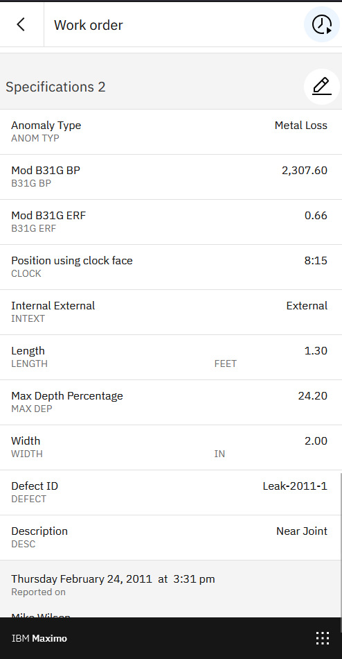

    I need to make WORKORDERSPEC data editable in the Maximo Technician Mobile application. I've created a custom data source and implemented a sliding drawer UI, similar to the one used for assets. While the sliding drawer shows the correct number of rows, the fields are blank.
    My main question is how to correctly configure the WORKORDERSPEC table to be editable in the Technician application, specifically how to display and save the data within the sliding drawer.

    Displaying specification on work order details page:
    <box hidden="{page.state.noDataFoundErrMsg}" padding="{app.state.screen.size === 'sm' || app.state.screen.size === 'md' ? '0' : '.5'}" padding-top="1" id="">
            <!--<border-layout hidden="{!woDetailResource.item.assetspeccount}" padding="{app.state.screen.size === 'sm' || app.state.screen.size === 'md' ? '0' : '.5'}" fill-parent="true" id="">-->
              <border-layout  hidden="{!woSpecResourceDs.items.length === 0}" padding="{app.state.screen.size === 'sm' || app.state.screen.size === 'md' ? '0' : '.5'}" fill-parent="true" id="">
              <top vertical-align="center" id="">
                <label label="Specifications 2" theme="20-regular" id=""/>
                <button icon="carbon:edit" kind="ghost" padding="false" on-click="opencustomSpecificationDrawer2" on-click-arg="" id=""/>
              </top>
              <start id="" width="100">
                <data-list datasource="woSpecResourceDs" show-search="false" id="">
                  <border-layout padding="false" slot="item" fill-parent="true" id="">
                    <start width="50" id="" horizontal-overflow="hidden">
                      <box id="" fill-parent="true" vertical-align="center" fill-child="true">
                        <field label="{item.assetattributedesc ? item.assetattrid : null}" override-required="true" id="">
                          <sub-field value="{item.assetattributedesc || item.assetattrid}" id=""/>
                        </field>
                      </box>
                    </start>
                    <middle width="40" horizontal-align="end" horizontal-overflow="hidden" id="">
                      <box padding-end="1" fill-parent="true" fill-child="true" id="">
                        <field value="{item.numvalue || item.alnvalue || item.tablevalue || item.datevalue}" label="{item.measureunitid}" override-required="true" id=""/>
                      </box>
                    </middle>
                  </border-layout>
                </data-list>
              </start>
            </border-layout>
    </box>
