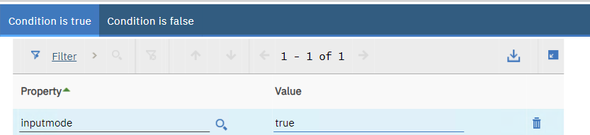

    Please refer: Configure Conditional Properties to make a field required  where you provide conditional properties against a signature option and a conditional expression and if it is true, use the property 'inputmode' and provide its value as 'true'
    also, when the condition is false, then provide value of this property to false
