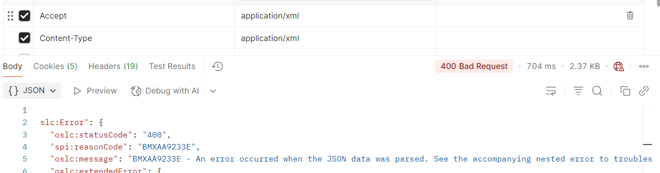

    Hi Alex,
    Thanks for your response.
    I'm currently testing the POST method in Postman. When I send the request in JSON format, it is processed successfully. However, when I send the same request in XML format, Maximo returns a JSON parsing error.
    Do you have any idea why Maximo is trying to parse the XML request as JSON, or is there any additional configuration required to support XML payloads?
    Any guidance would be greatly appreciated.

  • 8.  RE: MAS Integration
    Posted 24 days ago
    The /maximo/api/os/<object structure> route is synchronous in nature and only accepts/returns JSON payloads. You cannot pass an XML payload through that route.
    There are other routes that can perform both synchronous and asynchronous transactions that can accept XML. For example, you can define an External System and Enterprise Service and use an XML payload for inbound integration using a URL like:
    https://[hostname]:[port]/meaweb/esqueue/[extsysname]/[enterpriseservicename]
    However, if you're able to use JSON format, the REST/JSON API from IBM is quite good.

  • 9.  RE: MAS Integration
    Posted 24 days ago
    Is the XML format available as a dropdown option in Postman? The selected format is JSON. Ensure there are no formatting conflicts in your URL also.
    1. URL Structure (GET & POST)
    Maximo APIs require specific base URLs, authentication, and endpoints. Append query parameters directly to the URL.
    GET Request Example (Query by ID)
    • Fetches a specific Work Order in XML format:
    • https://<maximo_hostname>/maxrest/rest/os/mxwo?wonum=1001&_format=xml
    POST Request Example (Create Record)
    • Creates a new record and uses lean=1 to prevent null records:
    • https://<maximo_hostname>/maxrest/rest/os/mxwo?lean=1&_format=xml
    2. Postman Configuration Example
    To run these calls successfully in Postman, follow this setup:
    Step A: Authorization
    1. Open the Authorization tab.
    2. Select Basic Auth from the Type dropdown.
    3. Enter your Maximo Username and Password (or API Key).
    Step B: Headers
    To ensure Maximo correctly interprets your request and returns XML, set these headers:
    • Content-Type: application/xml
    • Accept: application/xml
    Step C: Request Body (For POST)
    1. Open the Body tab.
    2. Select raw and set the format dropdown to XML.
    3. Paste the XML payload mimicking your Maximo Object Structure.
    Example POST XML Body:
    <?xml version="1.0" encoding="UTF-8"?>
    <SyncMXWO xmlns="http://ibm.com">
        <MXWOSet>
            <WORKORDER>
                <WONUM>1050</WONUM>
                <DESCRIPTION>Emergency Repair</DESCRIPTION>
                <STATUS>WAPPR</STATUS>
            </WORKORDER>
        </MXWOSet>
    </SyncMXWO>
