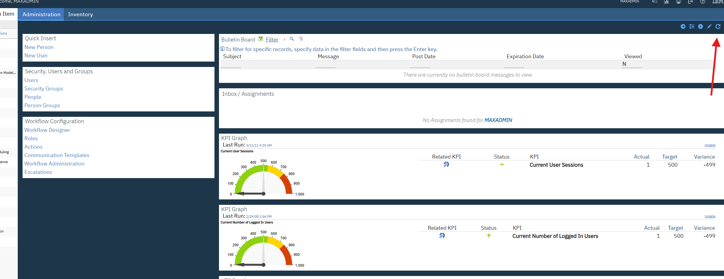

    If you have confirmed that the user is a member of the security group and have also confirmed that users in the same security group are not encountering a similar issues. Assist the Maximo user through the UI's Update Start Center Button in the screenshot below. The action should resolve the issue by resetting their start center.

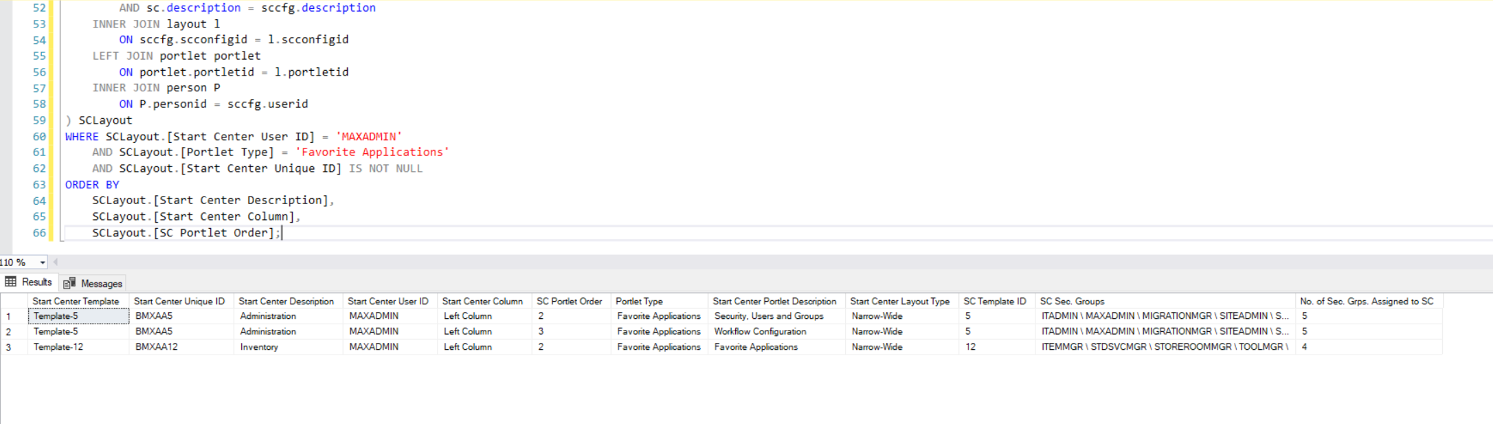

    I've included a Start Center configuration query attachment to use to validate user specific Favorite Applications driven by Maximo's Application Authorization rules. Ensure the affected user's security profile matches the security profiles of other group members. If issue persist, clearing the user's browser cache should resolve the issue.
    Expect the below results from the attached query.
