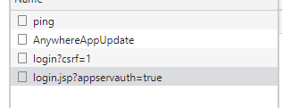

    Checking network traffic from mobile app to server I can see only this.
