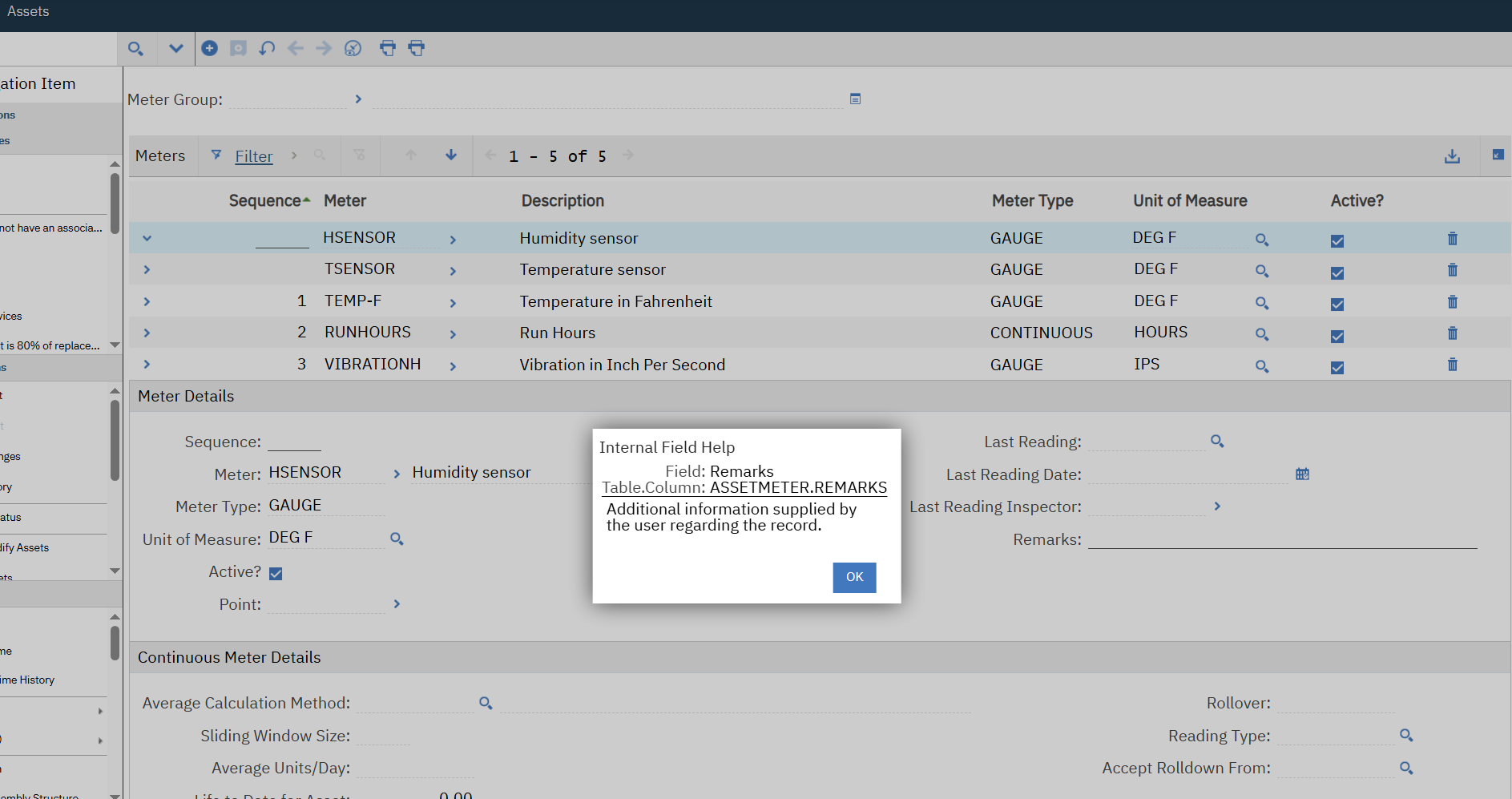

Sometimes it seems that there is no logic. There are two use cases here:
- As a technician, I need to see any specialist information about either the meter or, more specifically, how to take the reading for that meter, so that I can correctly take a reading.
- As a technician, I need to be able to record commentary about that specific reading, so that the engineer or the like, when reviewing the meter reading history, can see my comments, so that they can take any action that may be necessary.
As Steffen has said, based on use case #1, it would seem to be illogical to give the technician the ability to edit the remarks field based on the premise that it's information to do with that meter on that asset. It's great that the field is available when taking a reading, but in truth, not many technicians take the time to expand the row to ready it. Therefore, the field should be promoted to the summary row of the table, made read-only, and, as Nancy mentioned, also relabelled.
Also, as Nancy said, you can add a memo field for use case #2.

Hi Nate.
I came across your thread while searching for the answer to the same question.
To me, it would make much more sense if it were a comment on the measured value rather than a comment on the meter itself. I don't see why our end-user should be able to add comments to the meter; that should be reserved for us as admins.
