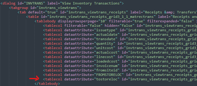

    Is there a way to modify the filter in the "To Location" column (the last column) from "View Inventory Transactions" and "Receipts & Transfers" tab? Currently, the list shows multiple storerooms for the item in that column, but we would like it to show only transactions for the current storeroom. So far, my searches on this forum or Googling have not yielded any results.
    I've looked in the LIBRARY.xml file and found where the "To Location" column is (see screenshot below), but I'm still not sure where to modify the filter for that column to show only the current storeroom. Any help or guidance would be much appreciated.
    Thanks!
    Brenda

    By any chance, are these items rotating? Looking at the MATRECTRANS relationship for INVENTORY, the out of the box relationship (in 9.1) is this:
    itemnum=:itemnum and itemsetid=:itemsetid and ((issuetype in (select value from synonymdomain where domainid ='ISSUETYP' and maxvalue in ('TRANSFER')) and tostoreloc = :location and siteid=:siteid and fromstoreloc is not null) or (issuetype not in ( select value from synonymdomain where domainid='ISSUETYP' and maxvalue ='TRANSFER') and tostoreloc = :location and siteid=:siteid) or (fromstoreloc=:location and fromsiteid=:siteid) or (issuetype in (select value from synonymdomain where domainid='ISSUETYP' and maxvalue='TRANSFER') and rotassetnum is not null and tostoreloc is not null and siteid=:siteid and fromstoreloc is null))
    Up until the last portion, that looks accurate. However, the last section is this:
    If a rotating item is transferred within the site, it would show up for every storeroom provided that the original location is not a storeroom. For example, if you had asset 1001 that was in operating location ABC and transferred it to storeroom LASMQBM and the storeroom LASMQBM is in the same site as XSTJMAS, it would show up in that scenario. This seems like an IBM bug to me. It should check the tostoreloc is for the current storeroom in my opinion.
