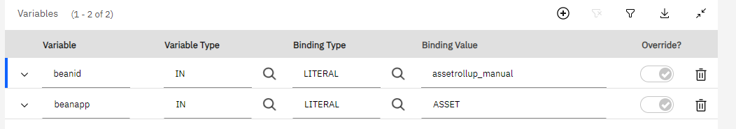

    I'm not sure I quite understand the use case of an action when there is no MBO in the dialog nor list tab. But regardless, without creating the signature option (because a signature option will lead to issues evaluating the signature option when there are no MBOs to evaluate) I tested this in the Asset application using the Maintenance Cost Rollup dialog since that is a dialog that can be opened with no records on the list tab. Next to the roll up all costs action, I added a new push button that invokes CUSTOMACTION.
    My databean script looks like this:
    def CUSTOMACTION(ctx):
        ctx.setEventHandled()
        ctx.closeDialog()
        ctx.error("emx","test")
    With the variables defined like this:
    The push button in the dialog (NOTE: no signature options were configured in the advanced tab)
    Then when I click the Custom Action it closes the dialog and throws the error (whether there are records or not).
