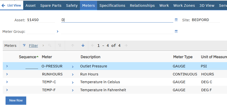

    Now, let's examine the option of having a meter as an asset.  Yes, this is valid, though not essential, as both the meter and the asset have the option to have a device ID assigned.  The core difference is that now you have to have a child asset with the meter.  If that meter is broken, you now have to do an asset swap, moving the broken one to a repair or salvage location and ensuring that the new one has a CM point assigned.  Is this when you want to know that it's broken?
    Ultimately, you inquired about "ideas that would require the least amount of paperwork and updating by a Maximo admin."
    1. Assign the meter to the asset
    2. Create a CM Point for the meter (NB: Do this first; you can skip #1 as Maximo does this for you)
    3. Ensure that the MeasurePointWoGenCronTask and the Organization are configured
    4. Record the meter readings
    5. Let Maximo generate the work orders (tracks that the gauge is broken)
    6. Issue the non-rotating gauge (tells us you installed a new one)
    7. Complete the work order and failure report (failure report tells us if you reset or replaced via the remedy code)
    As we have been talking solely about gauge or characteristic meters, you do not need or rather cannot use, the reset/replace meter function, as that is for continuous meters.
