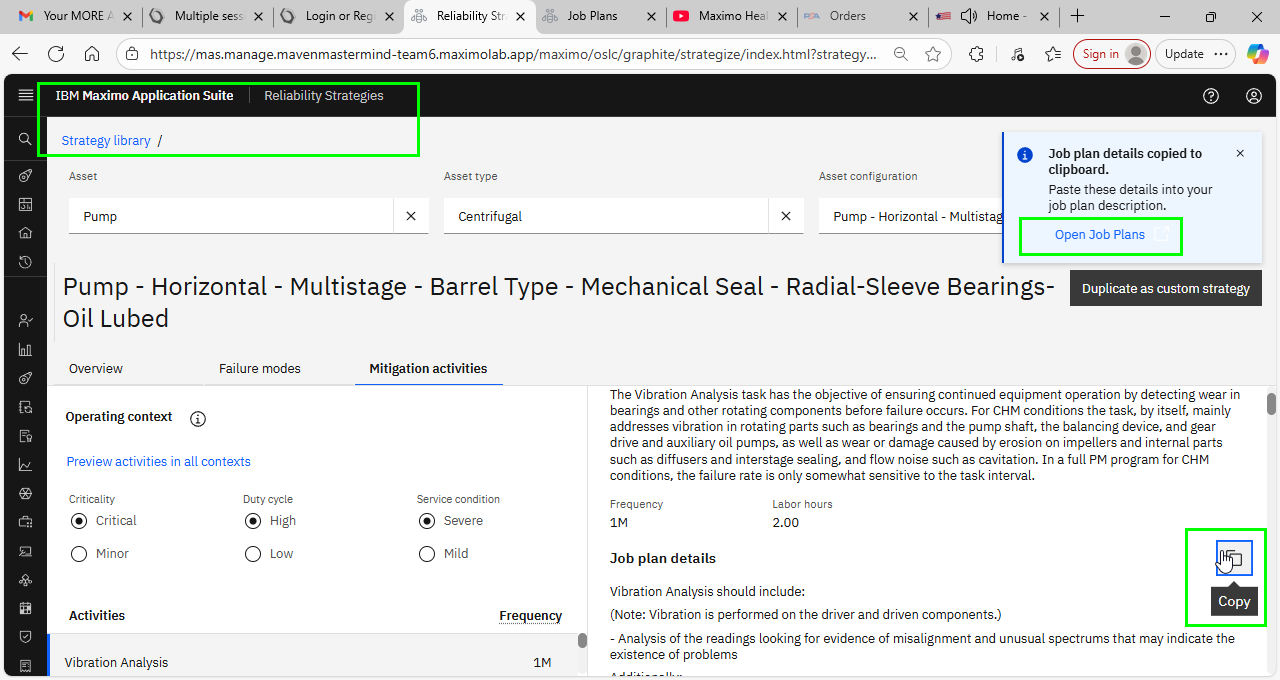

    When operating in 9.1.2, I've observed that in the Assets > Reliability Strategies application the pop-up that offers the link to "Open Job Plans" when you select the Copy icon for "Job plan details" in the "Mitigation activities" results in the application opening the Job Plans application in a separate Tab in the existing browser session (Currently MS Edge for me).  I've continued to fully navigate within MAS in both open browser Tabs and have not experienced any negative results thus far.

    While working in 9.1.2, I've observed that in the Assets > Reliability Strategies application, the pop-out that offers the link for "Open Job Plans" will open the Job Plans application in a second browser Tab.  The pop-out is produced when you select the "Copy" icon next to "Job plan details" in the "Mitigation activities" view of the primary application.  I've continued to navigate within MAS for my session across multiple applications within both Tabs and have not experienced any negative results.
