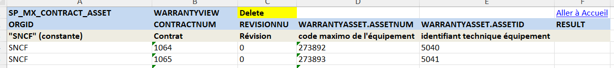

    Le voici la structure objet...

    The Delete action will delete the main record and all the related child. In your example it will delete the contract.
    Try to define an Integration Object Structure on the WARRANTYASSET object and use that one to delete the contract-asset associations. It is not guaranteed it will work but you can try.
    Another option is to create an object structure with just WARRANTYVIEW and the child WARRANTYASSET object. Then you can use the "Sync" action. This should remove any child assets that are not present in the MxLoader sheet.
