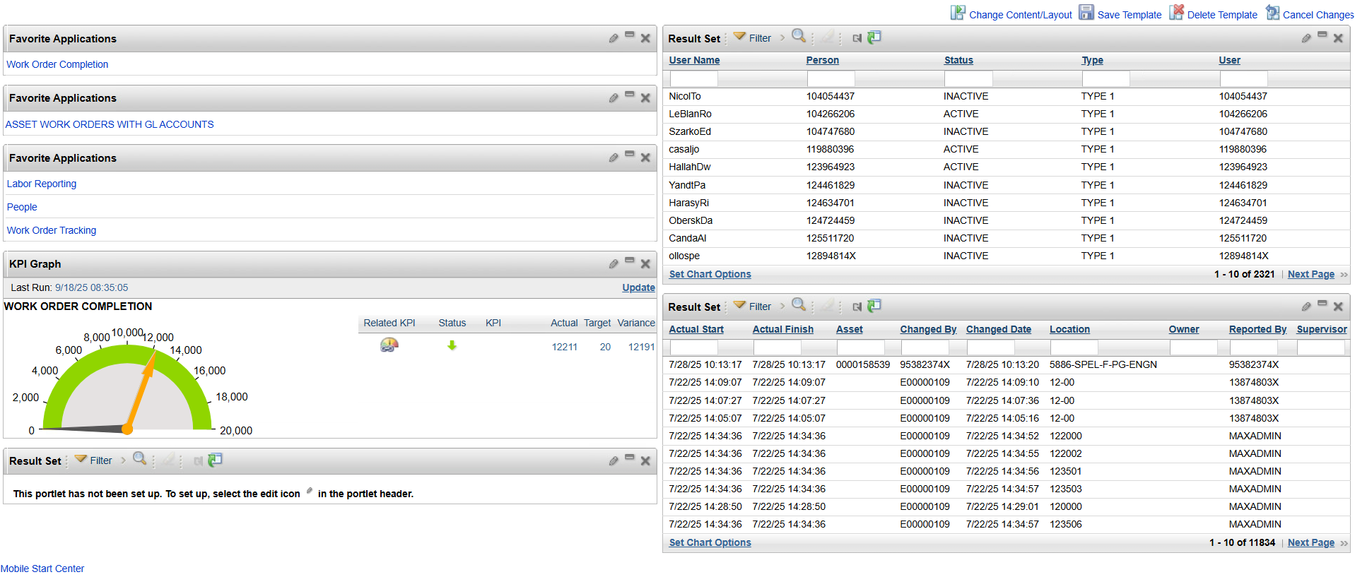

    As mentioned in the Subject line, I am tasked with the following using Maximo 7.6 in DEV environment:
    Develop a start center or application that has the following metrics (users must be able to select an employee and show the work order completion by month). I have setup a start center that shows the following:

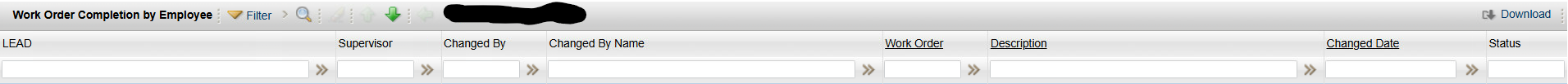

    I have even created an application:
    so my question is,  in the start center, how can I create a visual form where let's say, for example, a manager will click on a user and see the work completed by month for that user.  (For eg, manager logs in and wants to see what USER A did for the month of june.)

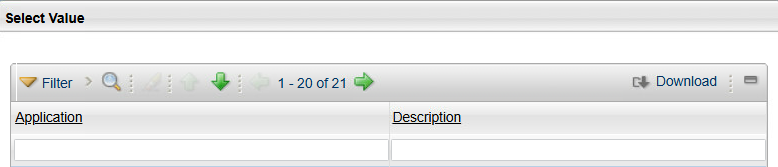

    I tried pointing my application, Work Order Completion in a new Result but that does not pick it up:
    in the application field, I can not get it to show my application.
    This is where I am stuck.

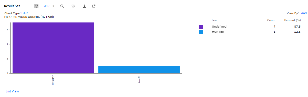

    I might suggest bar charting with the filters by person assigned to the work within the Owner Group (or Crew).  If the group is setup with those folks then you can have a query that looks at their open work for one portlet and completed work for another.  That might be an easy fix for your review. Something similar to this
