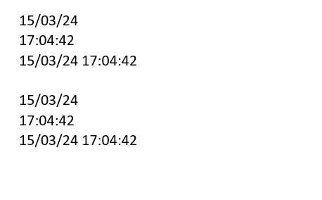

    Hi Stevie
    Look, These 3 option seem to work from a Communication template and they should work
    :DATE
    :TIME
    :DATETIME
    :date
    :time
    :datetime
    I hope so. Regards!
