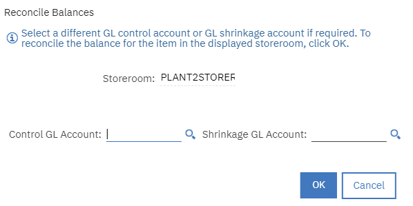

    I was wondering if anyone could help me understand what the benefits are of "Reconciling Balances"?
    The only thing I understand from our MRO department is that when a Physical Count or Current Balance is updated, you have to run the "Reconcile Balances".
    I was asked if it is possible to turn it off, but before checking if that is possible I was wondering what was the reason it is there for and what is the best practice?

    The purpose of inventory reconciliation is to make any necessary adjustments after a physical count was performed. You don't need to do it if there are transactions (IE receipts, issues, etc.) in/out of the storeroom, only physical count.
    If Maximo thinks you have 5 of a given part in a storeroom, you go and do a physical count and only find 3, the reconcile will create the financial adjustment for the 2 and update your current balance to be 3. Without this, Maximo will continue to assume you have 5 of that part on hand and may not trigger required activities like a reorder to replenish the storeroom.
