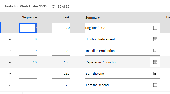

    To capture costs against the individual assets, you either need to change to
    • Tasks.  Therefore, you need to tag task# when issuing the items.  This is because each task will have the asset. But you lose the ability to add a JP.
      • If you create a WO, then add the route, you again lose the ability to add a JP, but of course can still manually add additional tasks.
      • If you create a PM, add the route and a JP, when you generate a WO all is good, but is it?  You can certainly issue to the task #, but the actual assets are mixed with the JP tasks and looks like the following pic.  NB: I have used the description field on the route stop to have a custom summary.  If you don't then it will be the asset description.
    • Child work order. Each asset will, of course, now show up as a child work order, but you can have a JP assigned per asset.  However, unlike the tasks, you need to have the WO# as you need to issue to each child work order, which equals much more work.
    • Multiassetlocci. You must override the asset# when issuing the item to the work order.  Again, much more work and prone to error.
    The simplest and easiest way is to use tasks.
