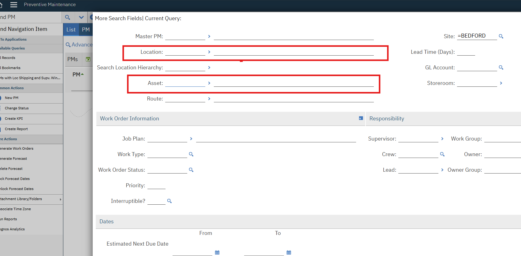

    OOB, the PM application's More Search Fields has both Asset and Location Fields. (Option 2)

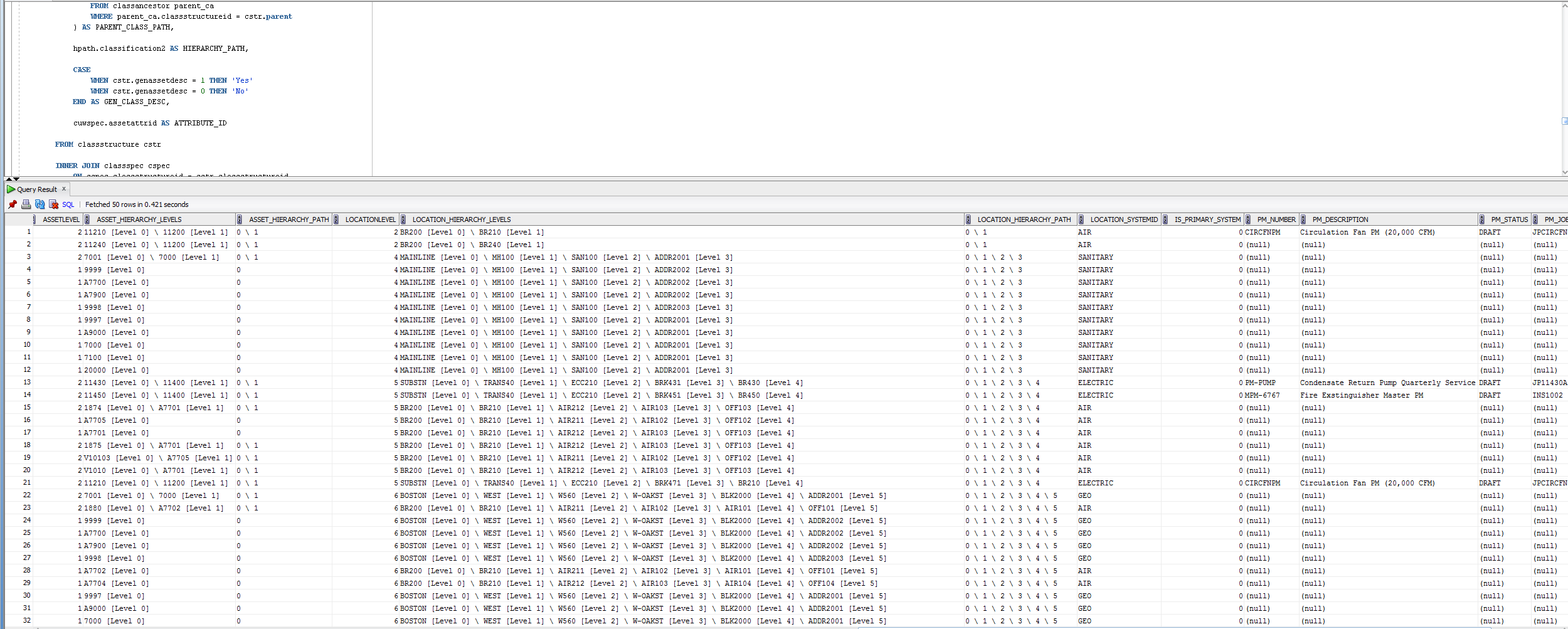

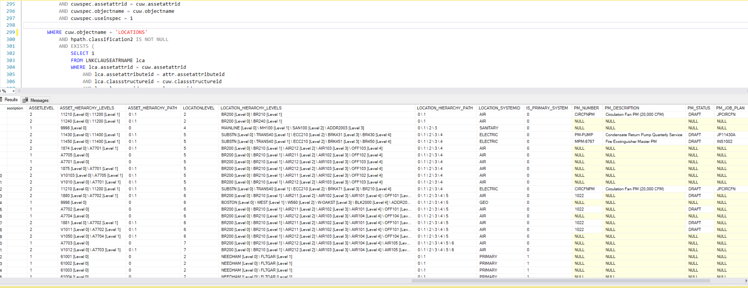

    Lastly, I created the attached query. I included both Location and Asset Hierarchies, including PMNUM, to fetch the data if the UI is insufficient. (Option 3)
    SQL Server Validation: To compare 'ASSET' vs. 'LOCATIONS' outputs, change the object in line 299.
    Oracle Validation:
    I acknowledge that these hierarchical queries are difficult to map. These queries are my service back to this community. I acknowledge their need for many ongoing Maximo upgrades.
    Who should I send the invoice to? My humor:😉
    Hope the community at large finds them useful. I did not have a DB2 database to test the DB2 Query.

    @Geoff Stokes - The SQL files did not upload. Please see the TXT versions attached.
    Fredrick Ndwaru

  • 8.  RE: Searching to PM records
    Posted 5 days ago
      |   view attached
    Oracle Query
    Fredrick Ndwaru
