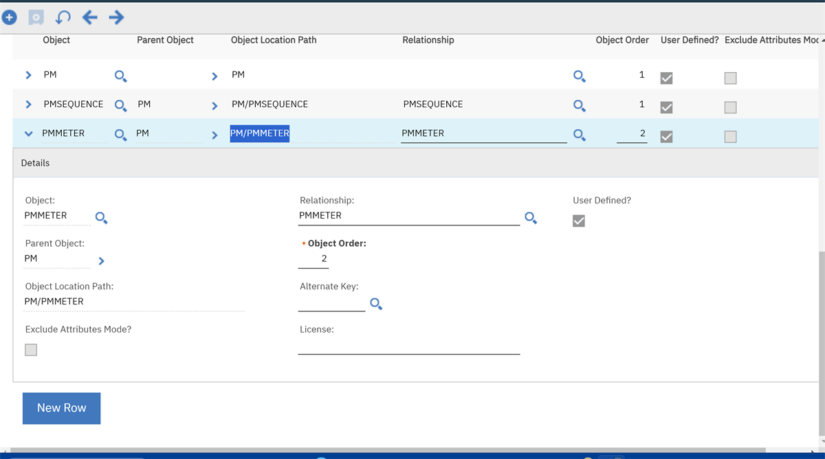

    1. I am trying to create a PM with a Meter Based Frequency, so I need it to create a New Row and check the boxes.
    2. I have created the Object Structure:  PMMETER
    Here is my setup of MX Loader
    The PMMETER columns do not retrieve any information when I Query to test them out.
    Is there anything else I need to do or fix?
    Thank you in advance.

    Hi Danny,
    If you originally used the wizard, there seems to be a defect where it adds a <return> for any column that uses a relation.  Whilst it looks good, you do need to remove the <return>.
