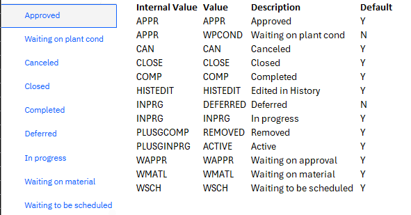

    I want to  show COMP/CLOSE at bottom of the  statuses in change status dialog window in workorder app, i did checked the  library.xml and app xml but could not see where the order is sorted . Does any one fixed that anytime?

    They are sorted by the VALUE of the status, that is CLOSE is before COMP within the internal value as you can see below.
    So, you would need to change the value to like 10COMP, 01WAPPR in order to control the list.
