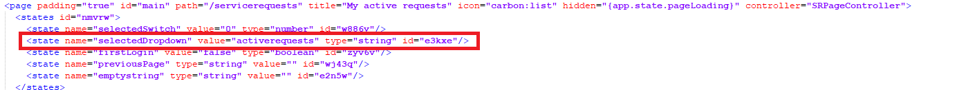

    I'm adding three custom queries to the SR Mobile app and running into an issue where the app always falls back to "Active Requests", no matter which query I select.
    Here's what I've done so far
    • Created 3 custom Object Structure queries in MXAPISR.
    • Added 3 additional datasources in the SR XML, mapped to these queries.
    • Added three dropdown controls in the XML.
    However, whenever I select any of the custom queries in the app, the SR List still loads data based only on Active Requests. It looks like the app is overriding or ignoring the query I'm trying to apply.
    What is the correct way to force the SR List datasource to honor a custom OSLC query instead of the default one?
    Any guidance or examples would be really helpful.
    Thanks in advance!

    Check this section and comment if it may help.

    Found solution here: https://ibm-maximo-dev.github.io/configuration-practices-documentation/complex/add-query-sr-app
