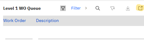

    Sometimes it can be the small things in Maximo that ends up being a game changer for a user's workflow. For me, one of my teammates pointed out the icon on Start Center portlets recently called Open Result Set in Application.
    When you click this icon, it takes you to the application with the same results with the where clause already applied.
    The difference is:
    You can now tab through the records
    You can navigate using list view
    You can take action on each record
    Instead of working inside the portlet, you are now in the full application with the same data set. This exists in both Maximo 7.6 and MAS. It is a small feature, but it can make working through records much easier.

    Opening the result set in the application is also more efficient than working in the list view to open records.
    If a user uses the result set to open individual records & returns to the portlet then the start centre is loaded again.
    I discuss the impact of this behaviour in this article - https://www.linkedin.com/pulse/using-sql-tracing-start-centre-performance-problems-mark-robbins/
