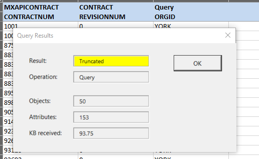

    Hello all,
    I'm having some trouble with the out of the box object structure for Contracts. When I look at the backend CONTRACT table in the database it has data but the object structure doesn't seem to be giving me anything. I did manage to load contracts in using PURCHVIEW but I am still confused why this structure does not work?

    Hi Christopher.
    I made sure I had the latest 8.3.5 version and I did try using the MXLoader wizard. When I only added PKs, versus R values versus adding all columns for MXAPICONTRACT via the wizard it still returns no records.

    Jennifer,
    When using the wizard from MXLoader make sure you select the fields that are Primary K (PK) and fields that are Required (R) in the list. From your screenshot  you provided it looks like you are missing these key fields, whereas in Christopher's screenshot he has the fields. I would start with that. If it still does not work then I suggest looking at the SystemOut.log or SystemErr.log for any additional clues.
