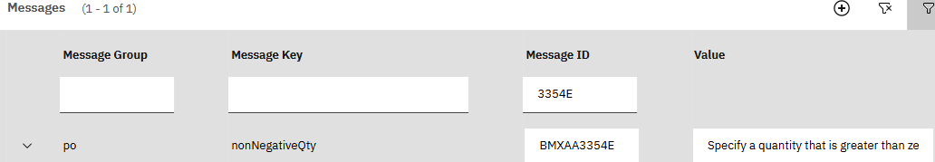

    You express that the issue only appears for going to APPR, but not COMP.  Let's look at that message.  When you go to APPR, the validation is on the WPMATERIAL, i.e. the planning side of things.  So, this means that you have entered some item on the Planned | Materials tab, but with 0.00 quantity.  Now, the thing is the default is 1.00, and yes, Maximo will allow quantities of 0 as per my screenshots from an approved work order.
    This leads me to believe that there must be something else, perhaps custom to your Maximo, that is enforcing a business rule requiring quantities when planning to be greater than 0.  Please review any automation scripts or check if we have incorrect information.  Looking at your error code, I found that it's registered with the PO message group.
    This leads me to the answer that there is nothing wrong, or at least should not be on the work order side.  Why?  I also looked at the scenario of approving a work order with a planned material with a quantity of 0, but this time as a "direct issue" to check if anything PO-related poked its head up and no.  I was able to approve.
    Therefore, you most likely have a custom business rule that reuses the standard BMX code, and you should look in that direction.
