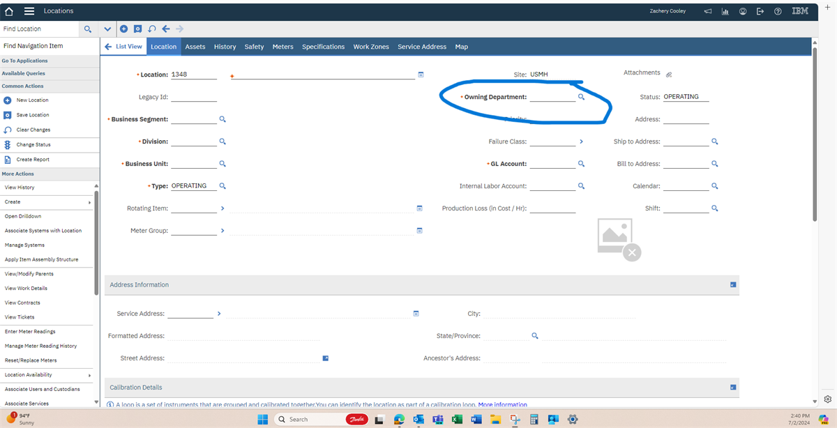

    I'm attempting to add a new location in Maximo, but I can't figure out how to add an owning department. Pictures attached for reference.
    Thanks in advance,
    Zach

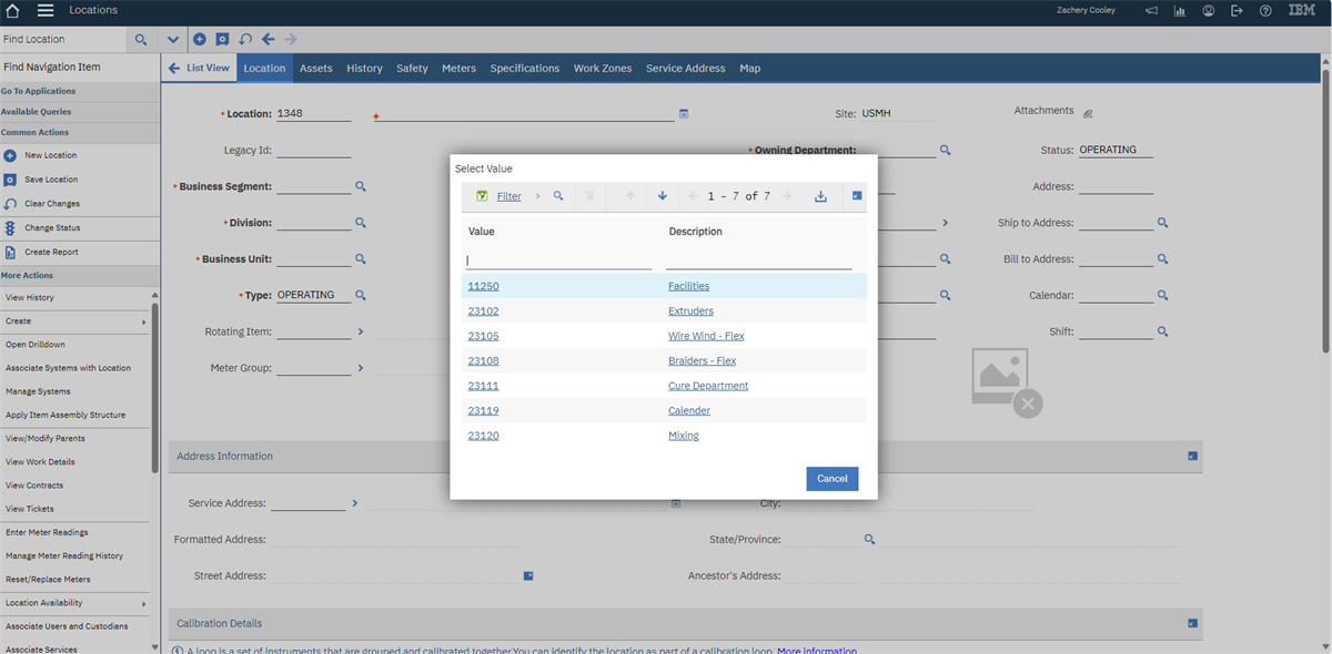

    It looks like you need to go into the domains application to add your new department value.
    Start in your test / dev or similar version to make sure this works before doing the same in production:
    Click on the field first, and then use Alt+F1 to find the field name.
    Go to Database Configuration and look up the field for the object based on the above result.
    Confirm the 'Domain' that you want to edit
    Navigate to the Domains application, filter for the Domain that was identified, and add your value and description there
    Make sure it shows up in the application and is selectable

    Thank you for the help, I was able to get it working.
    Thanks again,
    Zach
