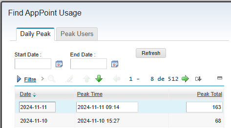

    IBM is providing a tool to help calculate AppPoints. You have to implement it to your maximo 7.6 ear file. You should contact IBM or the company that sells you your app points. They can certainly answer your questions. Once installed, the application will tell you, each day, your daily peak in app point consumption.
    Hope it answered your question.
    Danny
