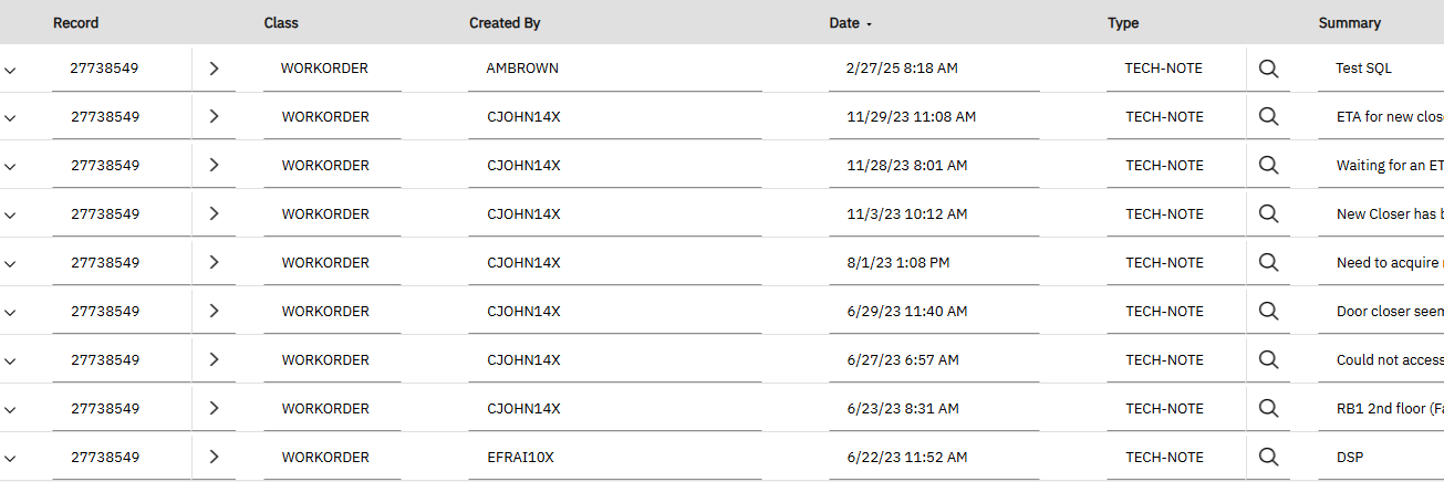

    In the email I do get the values for description and long description from the log in the closed WO. So if I have the following log entries
    I should get the last log entry dated today for example the AMBROWN item. But no matter how I switch it up I always get the last entry so for the example above I end up with the EFRAI10X the DSP item.

    I have tried both queries in the Maximo DB via Microsoft SQL Server Management and each item I get the correct answer i.e. the AMBROWN entry but when I try to trigger it via closing a WO. I always get the oldest record and I cant figure out if there is some other configuration that is reverting the result.
