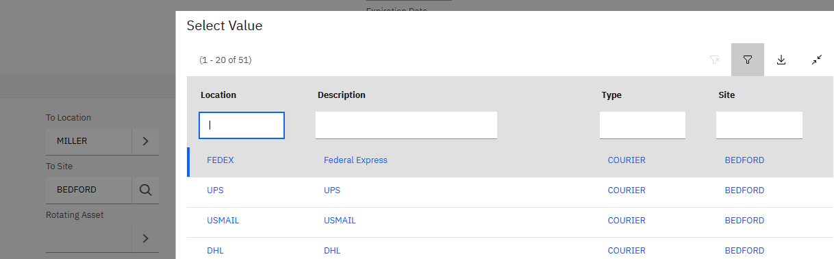

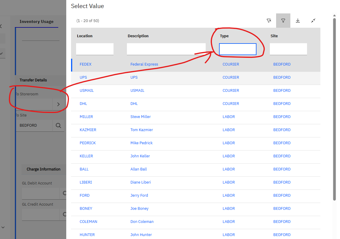

    A feature seems to have been missed that's very useful to both tools and items.  A labor can be set up as a labor inventory location i.e. a sudo storeroom
    This means that you can transfer items/tools to/from that location.  You will need to set the Usage Type to Transfer.  Then, when you select the storeroom in the following applications:
    • Inventory Usage, remove the defaulted value of STOREROOM and replace with LABOR or clear the value and search for the labor's name.
    • Issue and Transfers, using the Transfer Out tab, simply enter the labor's name in the To Location field.  Please note that if you do use the lookup, it does not need any defaults to be cleared.

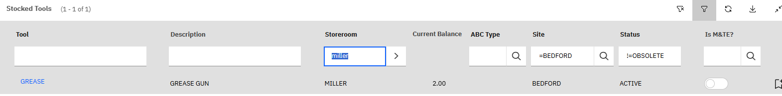

    In both cases, the result will be that the tool is transferred to the labor location.  You can then see from the Stocked Tools application: who and how many of the item that the user has.
    Being now a sudo storeroom, you can also return, but it must be as a transfer.
    Tracked tools
    Steven said that most companies do not track general-use tools such as drills and pliers and instead focus on the specialised or high-cost tools, which will be marked as rotating and thus tracked as an asset.  This is mainly because it does not derive value for the business, though you can argue that if you do not have the correct pliers when you need them, it could mean an additional cost due to downtime.  The above process helps you know whose got what, but it could be very granular.  For the "kitted" tool, you may simply be better off either listing the individual tools using the long description or have an attached document with them listed.  This way, when you check if they have all the kit, it's an easy check.
    You will note that the tool I used was not rotating, rather a stocked tool. Yes, you can have non-rotating tools in Stocked Tools.  You are only wanting to know how many tools you have.
