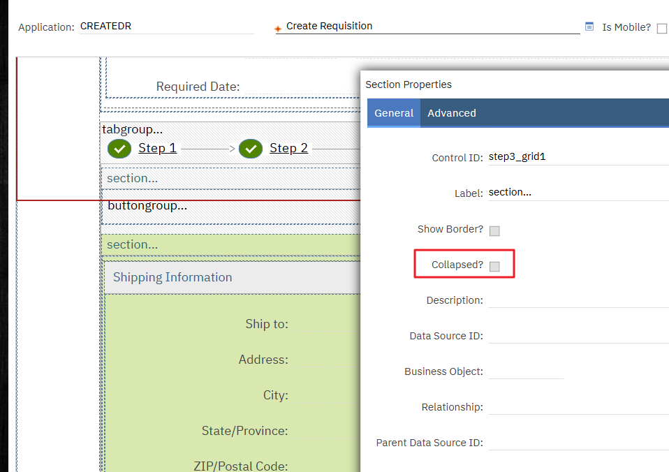

Keith Henderson posted 04-22-2025 11:03
Good day all
I would like to collapse sections of the Create Requisition but the option to Collapse is greyed out. Why would this be the case ? Thanks
Sankar Ganesh V S's profile image
Sankar Ganesh V S
The 'Create Request' tab is refenced form library.xml. Hence not available to edit directly.
You can copy the relavant contents from library.xml and include the CREATEDR application.xmlm then try to make changes.
Thanks!
