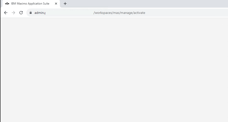

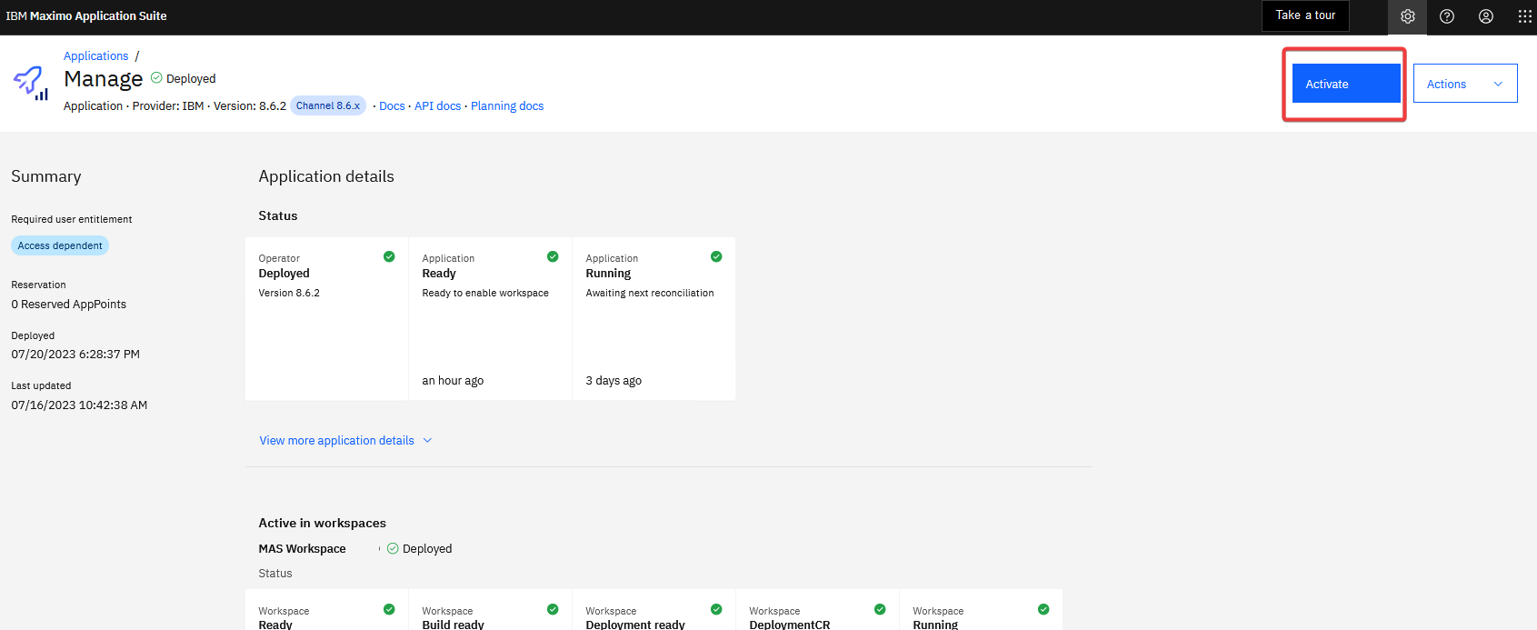

Hello, I would like to ask for help or hint what to check. I cannot activate Manage 8.6.2 because when I click on Activate button page is reloaded end it finish with blank page.
This is not new instance, it was already upgraded several time. Mas core is in version 8.10.2
It's deactivated now because the same situation occurred  (blank screen) when I wanted to update configuration, so I deactivated manage to try activation but it didn't help ;)
It looks to me like issue with code. Maybe some file/function is corrupted.
Thank you for any suggestion/hint where could be problem.

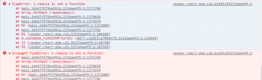

error from developer console in web browser
